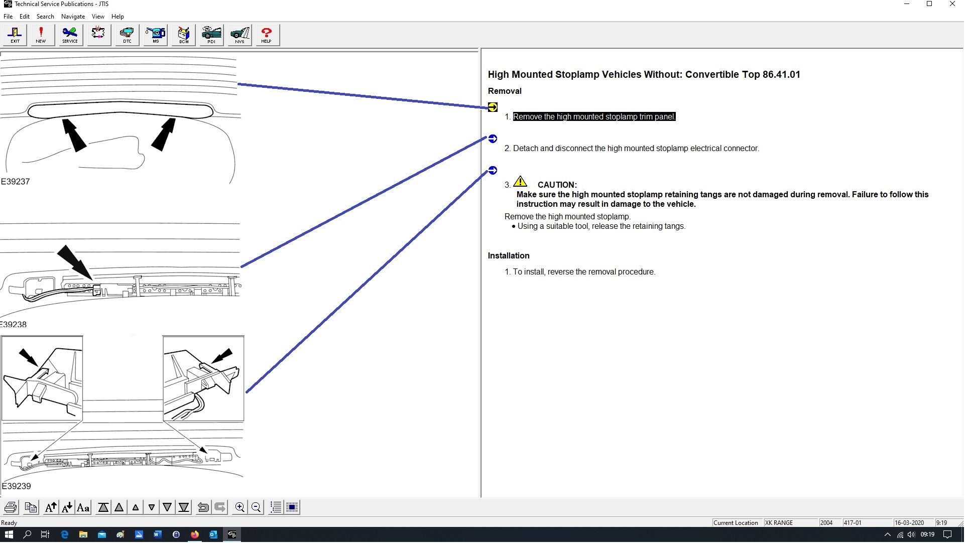

How is the third brake light attached to the rear glass on XK8 Coupe. I see what appear to be mounting clips on the rear glass but cant attach the light assembly to those clips. Any thoughts would be helpful.

I thought it was going to be the same as the X300/X308 with a stoplamp unit having slots that just slides onto two metal brackets bonded to the glass but the XK8 looks to be an even more fragile plastic assembly:
This is the Coupe section from JTIS.
A somewhat old thread, but I hope someone is monitoring. I am having trouble removing the High Mounted Stoplamp trim panel. I see that Step 1 of the JTIS simply says "Remove the high mounted stoplamp trim panel". Sorry, but I need a little more information. I can move the trim panel up and down, and I can twist it, but I can not "remove" it. I am obviously missing something. Help?
