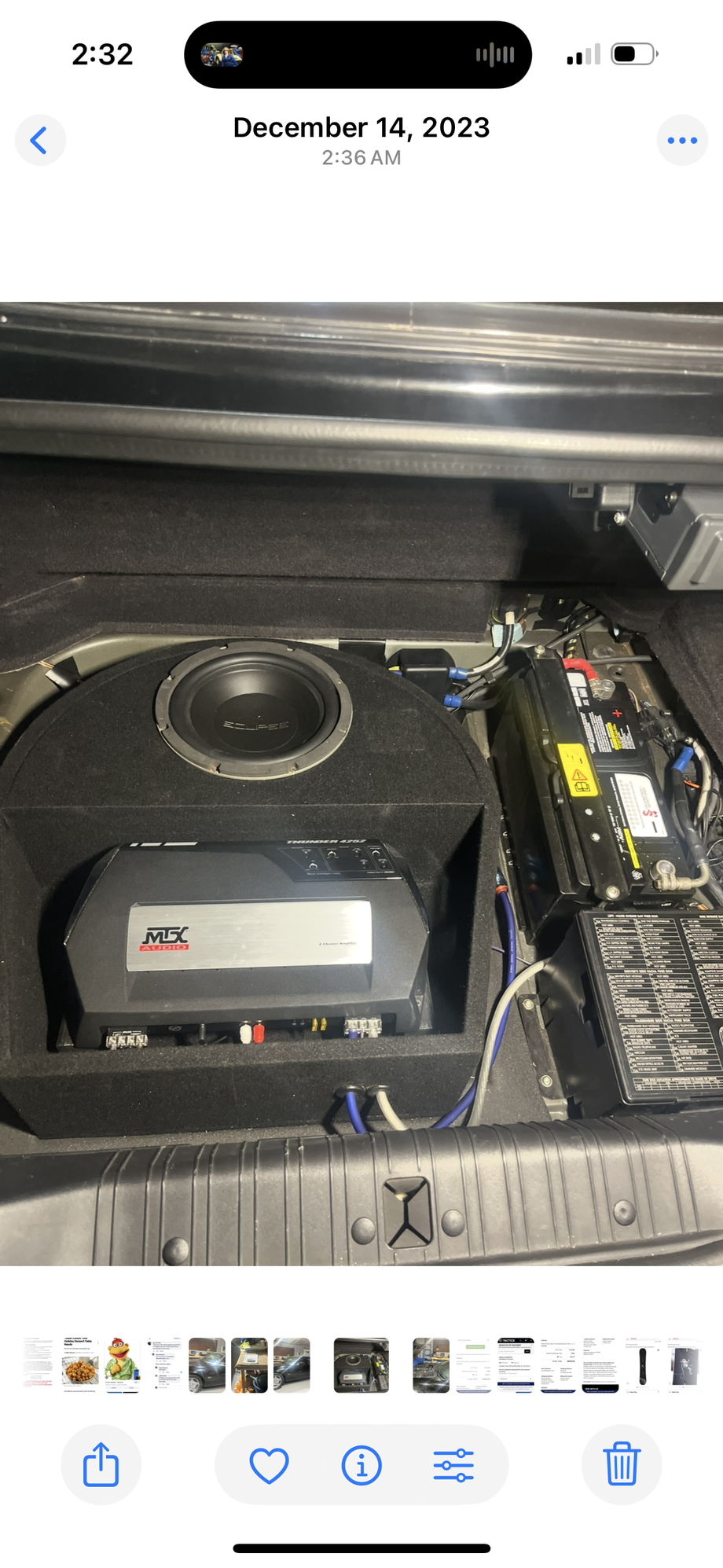

Here’s a shot of my trunk when I first completed my sub and amp install. I removed the spare wheel, and customized this box to fit the way I wanted it in the spare wheels place. I installed some dynamat under box before securing to the floor of the trunk. Ran all the wiring to be as discrete as possible. I can still put the trunk carpeted spare tire cover in with no problem to look completely stock, for display purposes. The sub in the photo was actually four subs ago, I keep blowing them because I turn it up to 11, because I can! I have blown about a thousand dollars of vintage eclipse subwoofers, from composite cone to titanium cone ones. They’re
very hard to come by and expensive, but I like it loud! I even have installed a much upgraded amp that runs 1500w x1 (bridged)@ 2ohm stable, which needed 1/0 wiring and an inline 150amp fuse, and blew a 200 plus dollar eclipse 10” titanium cone dvc sub in 12 minutes, on the first ride! Hahaha I was bummed out but that 12 minutes was f——ing glorious! (My girlfriend would probably disagree!) but hey, you only live once. So needless to say but I went back to the smaller amp ☹️. Now I got four or five subwoofers to rebuild… 10/10 worth it, would recommend if you’re as dumb as me, but be prepared for catastrophic failure!!
