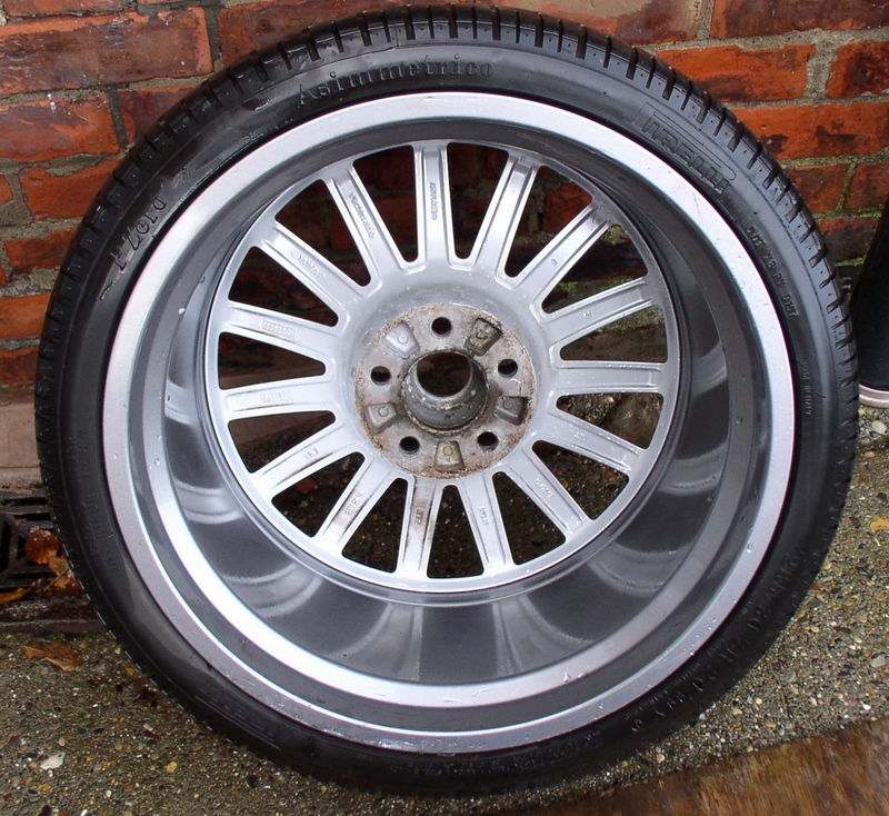

Old May 2, 2014 | 08:29 AM
Likes: 17,016
Originally Posted by Jsnyder0828
So, I know I'm a little OCD .........
If that's OCD, I'm not sure how you'd describe me!
I only do this twice a year.

That's the way wheels on cars like a Jaguar are supposed to look. Nice job. If you wax the inside as well as the outside of your freshly cleaned wheels before refitting them your twice yearly wheel cleaning ritual should become a once yearly event. My friends say, "why bother, no one can really see the inside of the wheels anyway." I smile and say, "I can".
I don't think that people that have high standards when taking care of their cars are OCD. Most people I know wouldn't take half a shower and think that they were clean. Seems your and my wheels already know that.
RB
