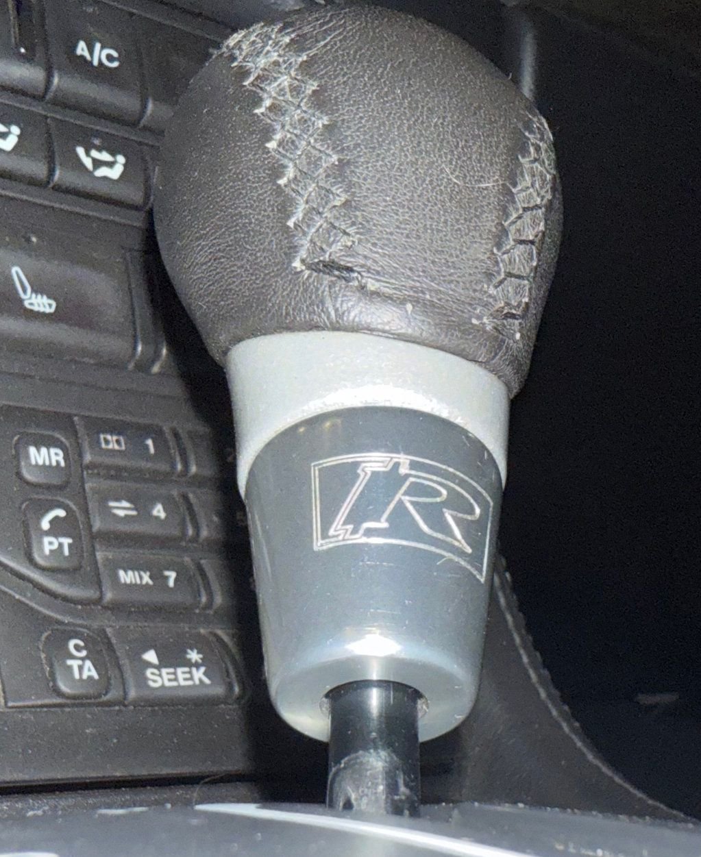

Hello trying to replace shifter plate on my car . Got down to only have to remove shifter knob . This is 100 anniversary car . There is a knob and a base with Xk on it with a small hole in back . Tried inserting small allen wrench but nothing seems to fix . No place to put a wrench to unlosen like on non 100 model . Any help would be appreciated. Thank you

Hello Don , thank you for the info . Issue is my cone has know way to put a wrench on it . It’s supposed to be a 16mm but my cone it tapered smooth with xkr on it . There is a small hole on the back tried standard allen wrenches and they don’t work.

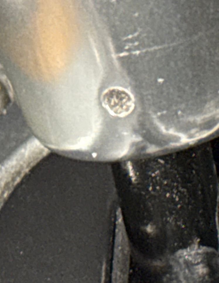

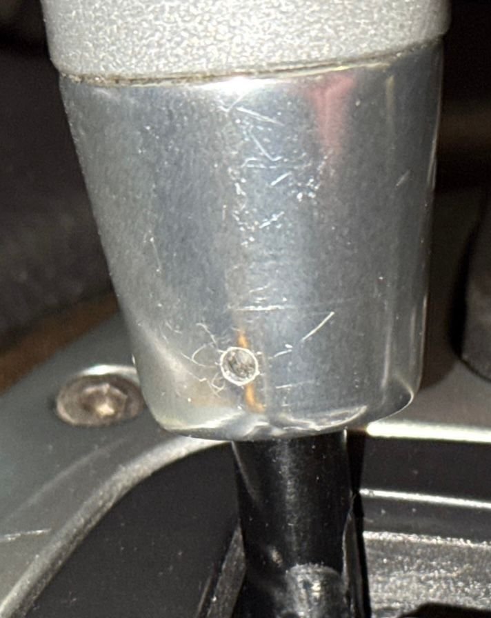

I have the same problem because I also have a 2002 XKR 100. When a repair person recently cracked my shift plate, now I need to find a way to remove the knob. I have not tried the scary vise grip solution mentioned above. From the looks of it, the hole on the front is for a pin that is in some sort of special Jag tool. I t may be a hole for a drift pin that locks the nut to the shaft, but I sure hope not.

First pics are from the front of the knob. This one is from the back.
