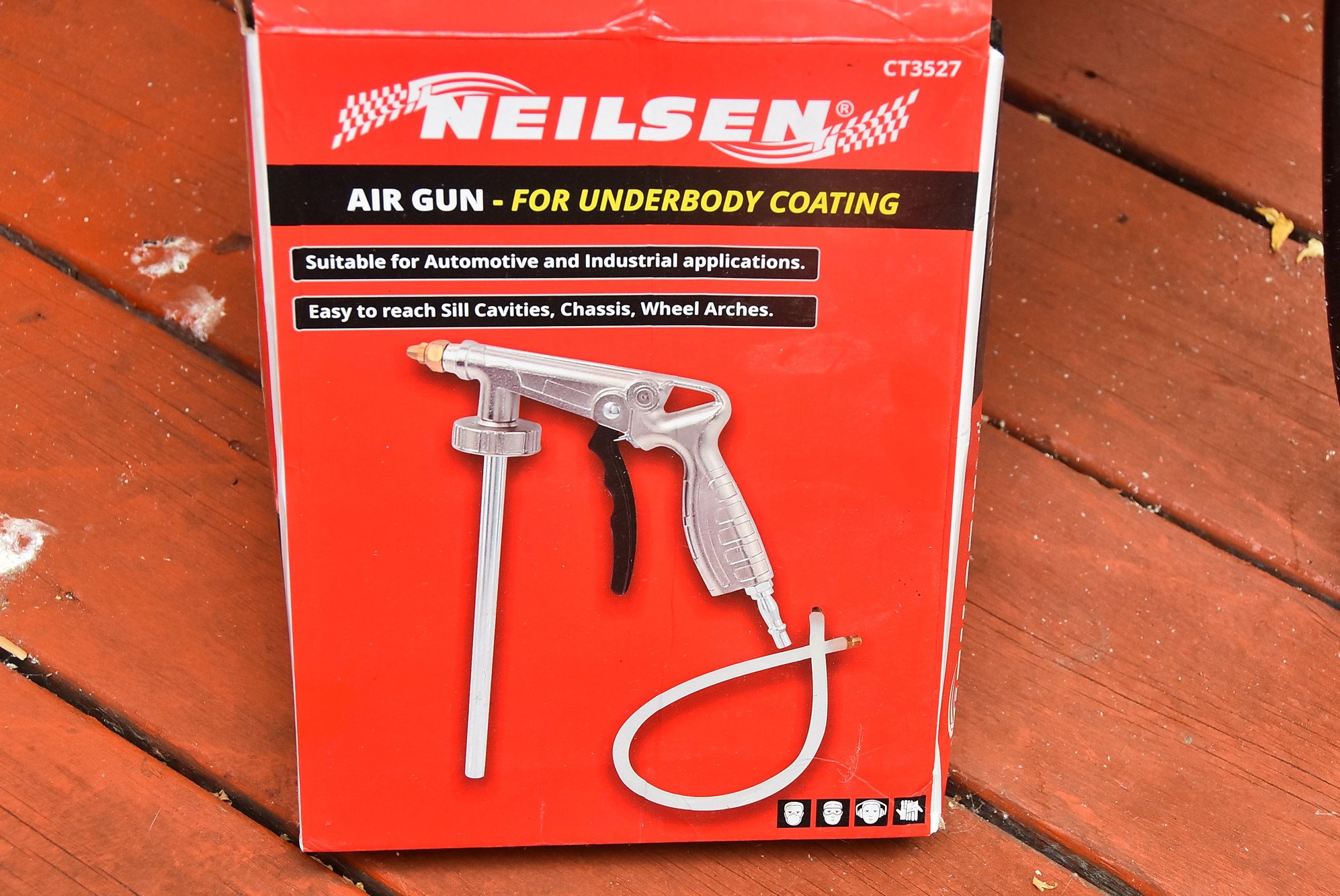

In the UK we use something called Waxoil been about for 60 years , 5 litre is about £30.
When you get it its too thick to get out the tin so you need to put it in a bucket of boiling water and stir until its liquid. Pour off about 20% and top up with white spirit or petrol. Mix thoroughly and pour off into 6 UK milk bottles . Its easier to warm one bottle for a job than the whole tin.
You will need a spray gun and an air compressor 1.5HP is fine .
Now you can buy cartridges of waxoil for the gun but its cheaper to buy a tin.
Drill the top of one of the milk bottles (1 litre) and fit to the top of the pick up tube and hold with a small worm clip. You can then screw the bottle onto the gun . No bleed hole required the gun will suck the bottle flat. Re warm an pour off any surplus
Photos below
ajfldj
The bottle on the right has been sucked flat.
gklhg
about £10
You can spray into the sills by removing the bungs front and rear and take off the tread plat and spray through the many holes it reveals
