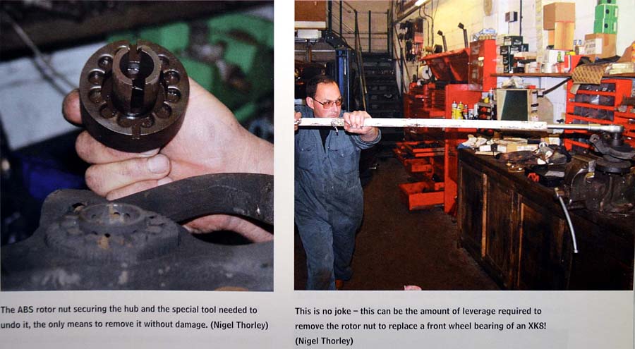

I removed the ABS nut from my 97 XK8 with a 2 1/4 inch 12 tooth socket. I did however, have to leverage the wrench with a 5 foot long pipe and it was still very difficult to break loose. I also took the entire spindle off and stabilized it in a vise.

This is what's involved:

Beware of the tools that only have a 1/2inch socket, I easily sheared off my 1/2 inch breaker bar.
The original tool had a 3/4 inch socket, so if you have a 1/2 inch one, weld in a 1/2 to 3/4 adapter and get hold of a 3/4 inch breaker bar.

Thanks. I used tractor sockets that belong to my wife's dad. I believe that monster must be a 1 inch. I can't imagine that a 1/2 inch would do it without breaking.
