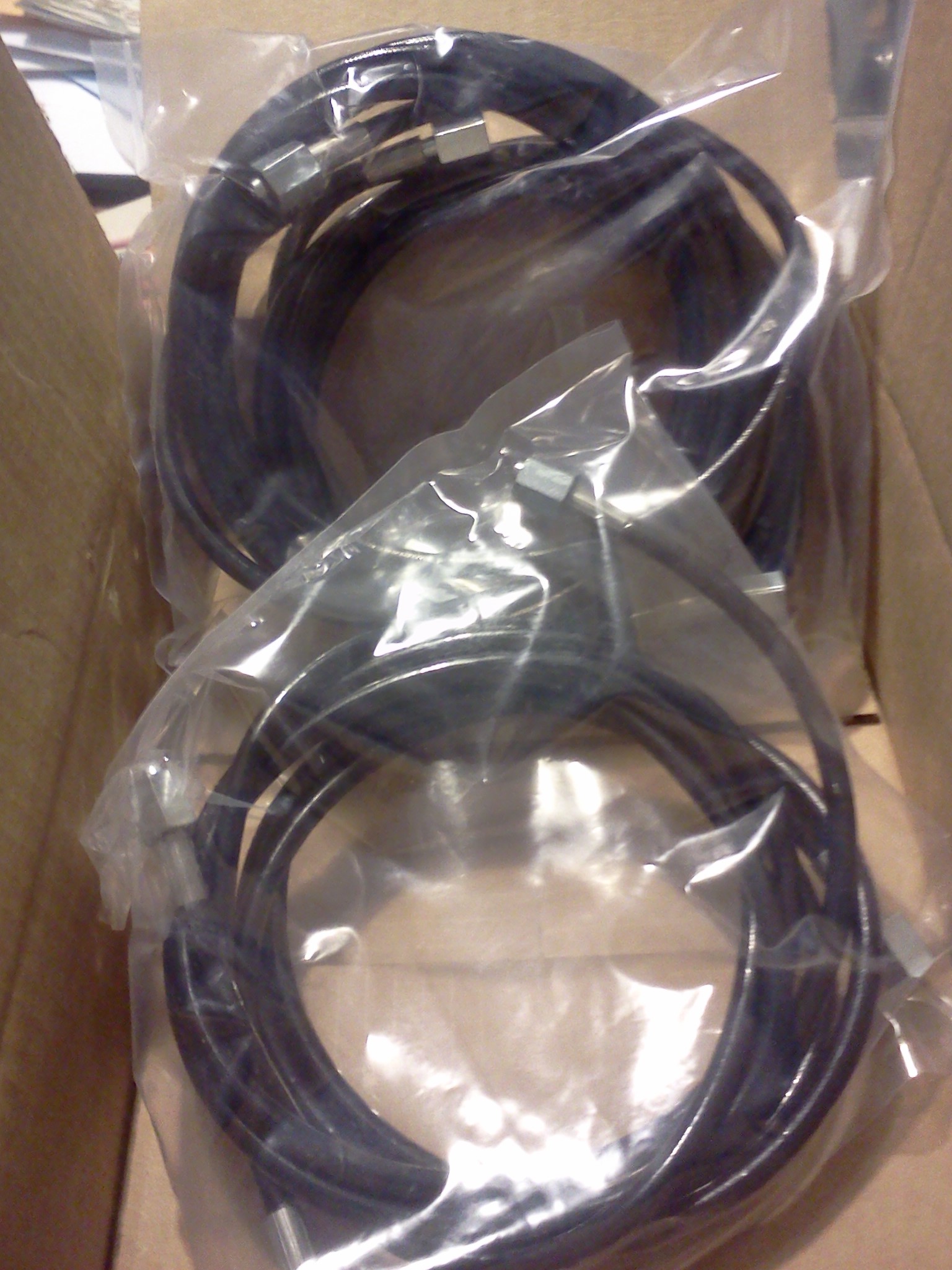

oh yeah can't wait to install these - been hell having to drive with the top up these last few weeks!

3.5 hours and cylinder hoses replaced, tested sat not to replace the rear seat and side panels - hell yeah - happy happy joy joy!!!!

I only had to replace the 4 cylinder hoses but I ran the new into place before removing the old - so it was just a matter of disconnecting old and reconnecting the new - even screwed up and had to come back to the forum - JTIS says bottom hose of pump rear connector goes to bottom connector on cylinder when top hose goes to bottom connector - but all good and working - now cleaning the seats and side panels before reinstalling and realigning the rear quarter windows to clear the slight gap when windows are up.

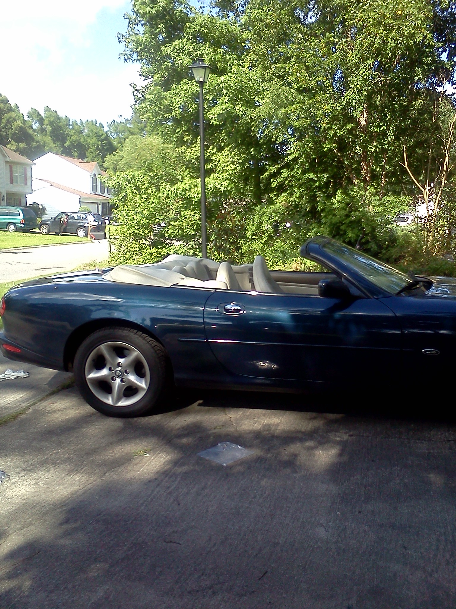

now to detail her and all will be good!

Sorry it did not work for you. I will check the link and see if I can find the cause. Enjoy the top down.
