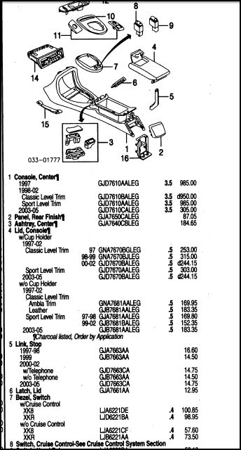

I am not sure this is the right part number. Anyone else have this part crack? I may just glue it but it is cracked in 3 places.
The parts on the parts list do not look the same.

Here's the bezels part #'s
Doug

I have not seen that part damaged before. I have looked in two different parts catalogs and cannot find that piece. I wonder if it is part of the shifter mechanism.

It's called a Gear Selector Illumination Module (LJA6195BF) and it's on the CAN. It is a listen only module.

module = money, no doubt. Better start looking at salvage yards. I too have never seen cracked ones, maybe a scratch, but not split like that.

That part number has been superceded by LJA6195BG.
Retails for $247.50
Parts.com has it for $185.
