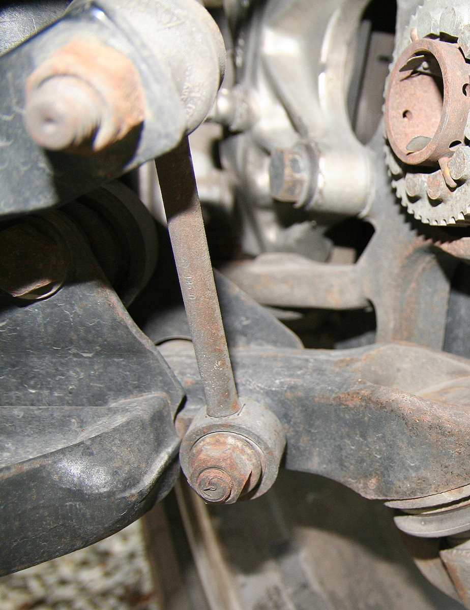

The bad roads of southern Tuscany are not doing the Jag well. Or they simply bring out some issues that have been there for some time, me unknowing.
Yesterday the car started getting this suspension clunk, which I now found that I can trigger with sharp right turns at speed. It should be clearly audible on this video:
Any ideas about the cause of this? With my limited car knowledge, I would suspect the anti-roll bar links. I took a picture of the front left anti-roll bar link, but I don't really know what it is supposed to look like. Perhaps the lower bushing of the link looks a bit worn, could this be the cause?
Attached Thumbnails Identify the clunk!-img_9840.jpg   Identify the clunk!-img_9841.jpg

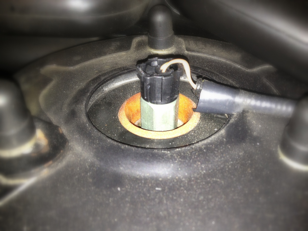

I hear it when going over bumps at any speed really. The only time I do not hear it, would be when going on a perfectly smooth surface. Also, turning sharp left does NOT cause the sound, only turning sharp right.
I snapped some pictures of the upper shock mounts just now, and from what I can tell, they look ok.
The search goes on...

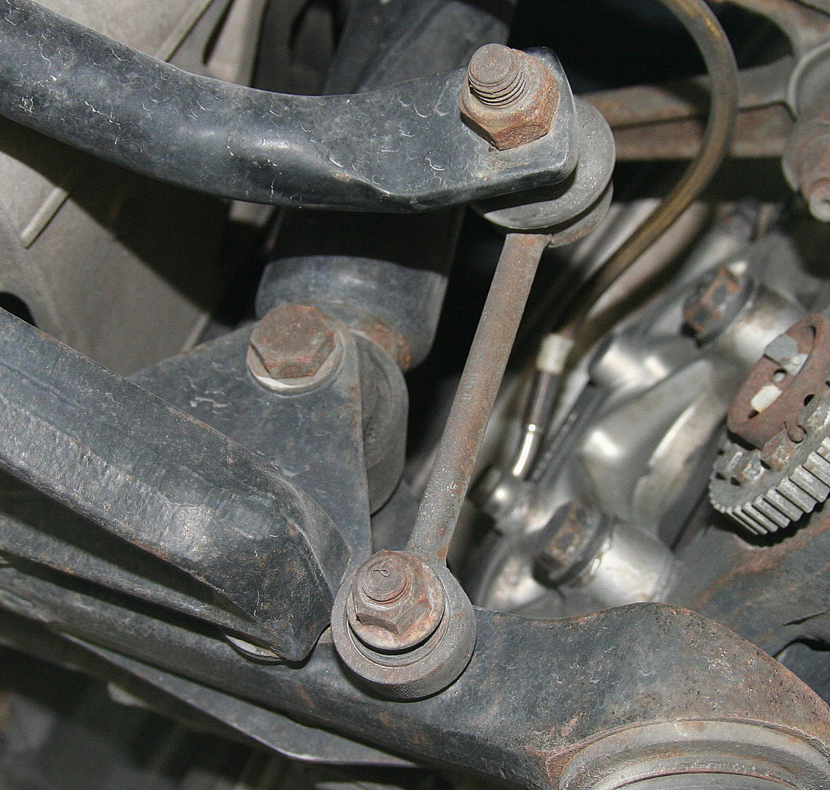

Check the strut brace first, after my complete bush/bearing/balljoint front end rebuild, I had a similar clunk from behind the dash.
I hadn't fully torqued up the brace beneath the windscreen, once torqued up the clunk was gone.
