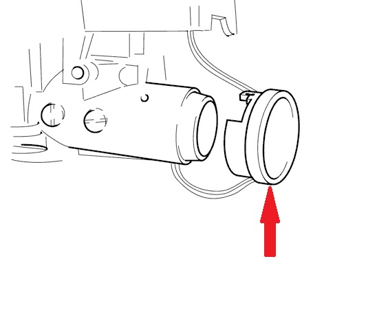

Could this be a faulty Key Transponder (a.k.a. Exciter Ring)?
These used to be extremely unreliable on the XJ40 although I haven't come across a report of a similar issue on the XK8.

I am NOT even going to comment on the name, but does the ring set off the chimes w/key in and door open?

JTIS has the procedure for the key cyl replacement. Looks pretty easy. My ring seems to cause a lock-up of the security system when it doesn't detect the key...everything goes dead, chimes and all. JTIS does't seem to go much into it, but a dealer a few years ago told me my "voltage measured low" at the exciter. Since it's intermittent, I've been living with it. Requires a reset at the battery, then all is good until next time (wife with me, pouring rain at night,dressed for a wedding, etc). My reading of the schematic shows that the key-in switch is responsible for the chime when the door is open so graphite that little flap door as suggested. Probably sticking open.

As Mike says, JTIS is very shy on information about the Transponder / Key handshaking procedure. The Transponder is what recognises the chip in the Key and allows the ignition cycle to operate. Exactly how it does this isn't described.
If you do go for a replacement cylinder, you'll have the additional trouble and cost of having the new key mapped to the vehicle unless it's possible to order an identical cylinder to the original from Jaguar.
