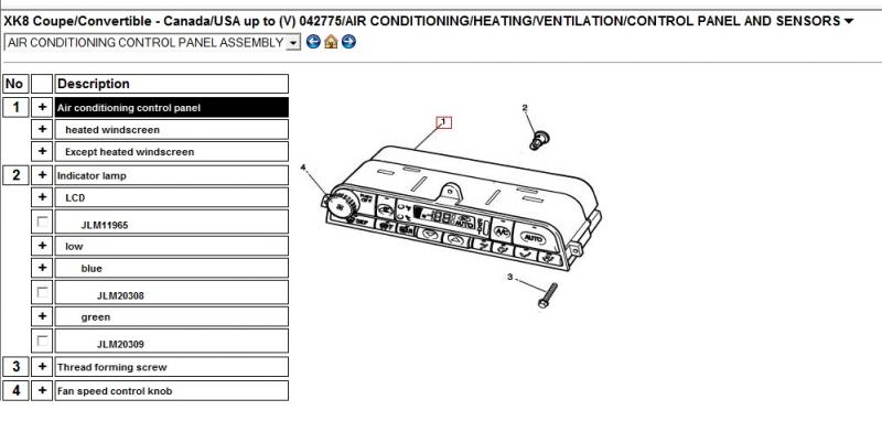

The Part Numbers are:
LCD : JLM11965 - quantity 2
BLUE : JLM20308 - quantity 7
GREEN : JLM20309 - quantity 2
There have been several reports of problems with aftermarket bulbs.
Attached Thumbnails Illumination Lamps behind Climate Control Temp display-xk8-climate-control.jpg
