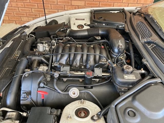

Thank you for the welcome. I own a Jaguar XK8 2004 Convertible. This is an amazing car. The best car I have ever had. The first Jaguar I had was a Mark 5, almost 40 years ago. To say there is a big difference would be an understatement. I imported the XK8 from the UK to Australia about 7 years ago. Its done about 120,000 miles now. I really appreciate the forum as it has helped me carry out various maintenace tasks such as changing roof hydraulics, door latches, suspension bushes, coolant hoses, water pump, thermostat, lights and of course O2 sensors.
