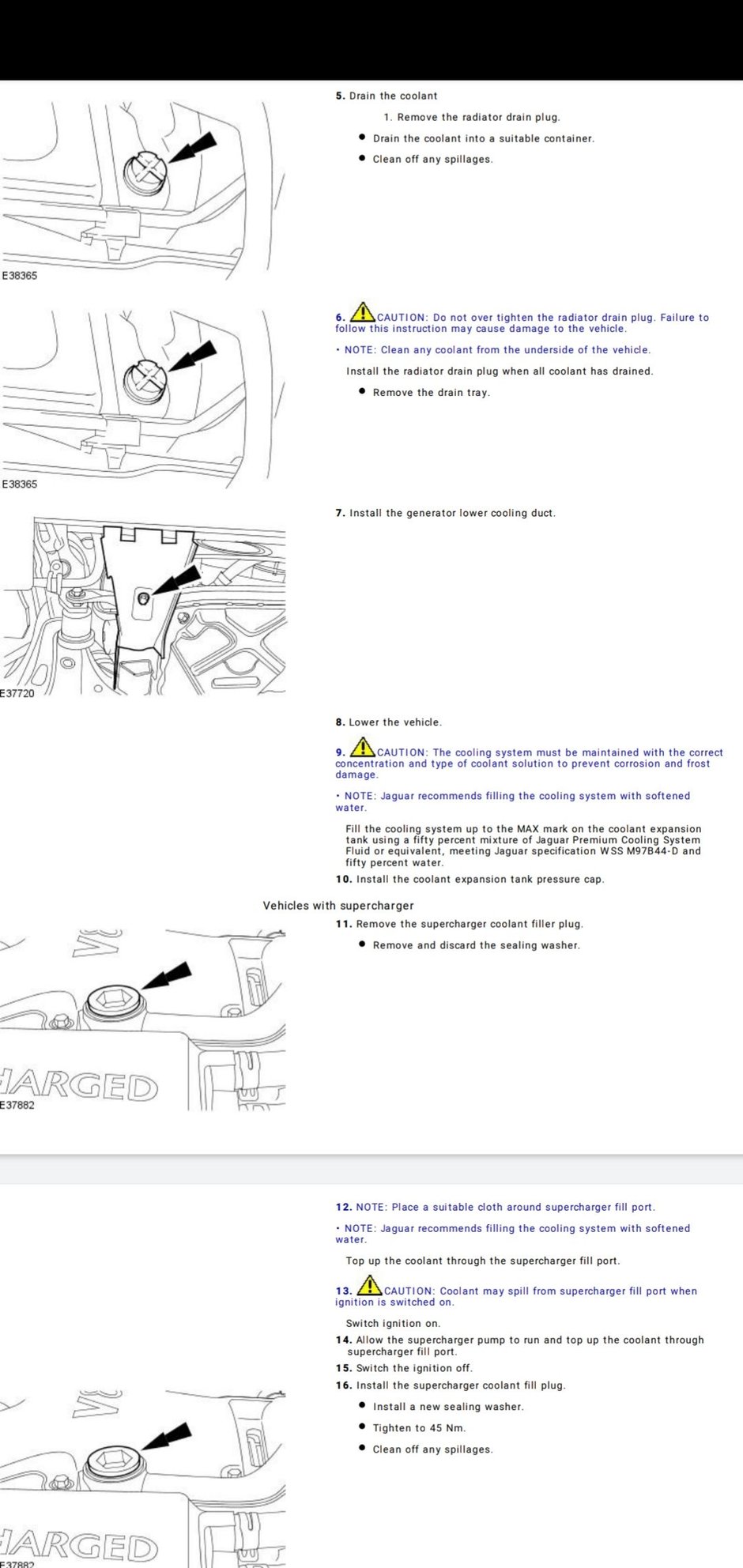

For what it is worth, on the 4.2l engines, the complete coolant system (including the supercharger rad) is drained from the main rad and then refilled via the supercharger filling port. See below excerpt from the workshop manual.

Thanks for that MrTexasDan put an article on the Forum some time ago about how to change coolant on a 4.0L XK8 and the differences for an XKR, he only used the one drain point on the main rad for both models, same as for your 4.2L. Will drain down from the single main rad drain point and check the intercooler rad for any residual fluid and action as necessary. Main thing is to ensure that both rads are refilled on completion!
