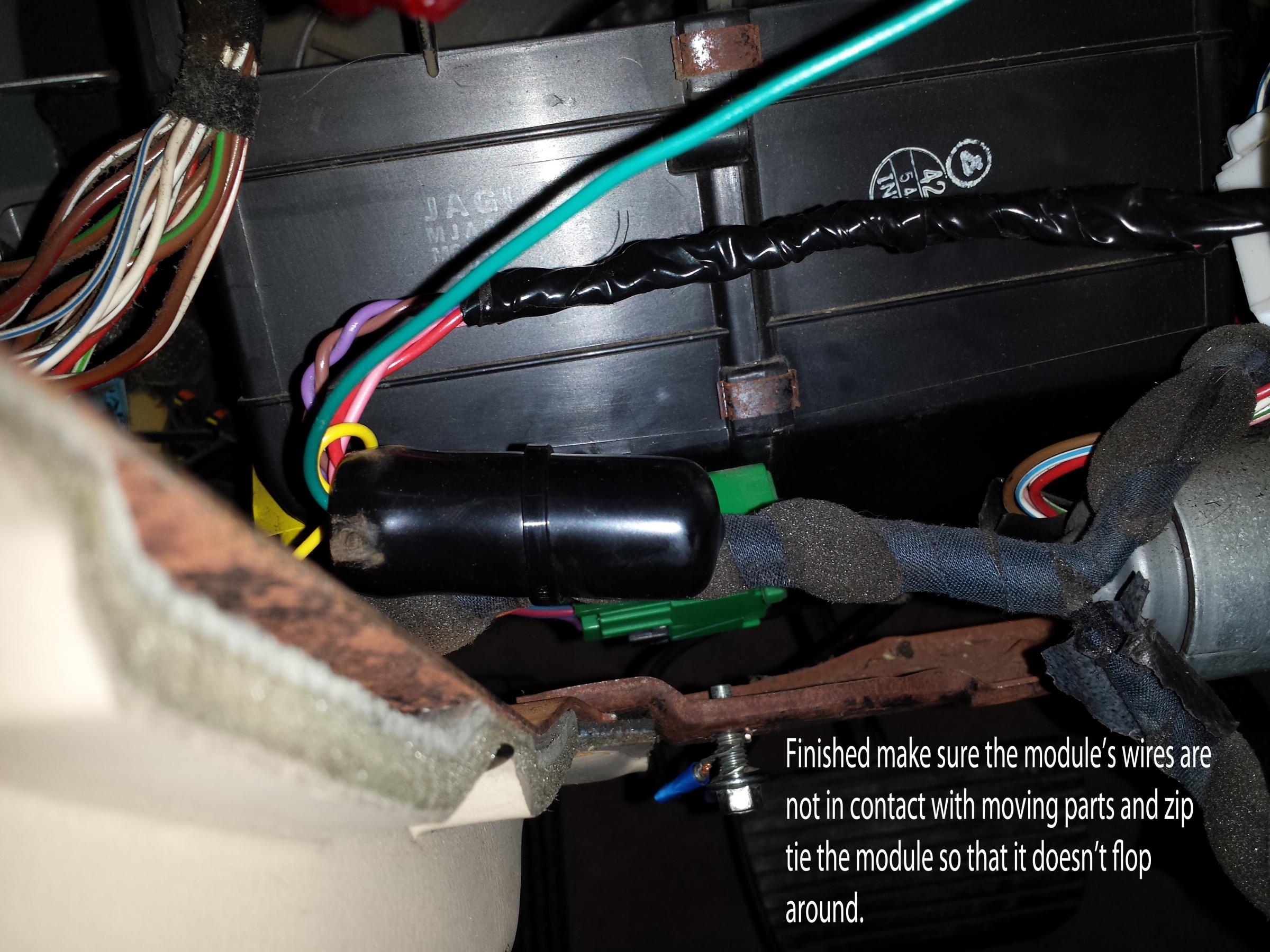

Hi everyone this will be my first DIY so bear with me please. My intent was to provide a feature that was not available on my/our car/cars. So let’s get to it! First I take no responsibility for any damage you or anyone may cause to their vehicle. Do this mod at your own risk. Don’t blame me! J I have no affiliation with WebElectric (WebElectric Products - Sequential Turn Signals, Sequential Taillights, Sequential Tail Lights, Dynamite Stick Sequential, Pulsing Brake Light Pulser Flasher, One Touch Convertible Top, Dynamite Stick, One Touch Turn Signals, Daytime Running Lights, L) other than I purchased the module (OTS-1M5 $40) from them. This mod was initially made for a 2005-2009 Ford Mustang but I saw that it could be used on our automobiles because of the way it is set up. I contacted the WebElectric and they helped me verify some of the wiring on their product. The WebElectric product adds a convenient One-Touch feature to your signals. When changing lanes or getting on/off freeway ramps, you just “touch” and release the signal lever. The signal will flash 6 times, then quit. The timing can be changed to a range of about 2 to 8 flashes. The lack of flash adjustment or only 3 flashes was an issue with some members on another Thread but this is resolved with WebElectric’s module and stock setup of 6 flashes is more than what some people use here in Texas. First, please disconnect your battery before you even start. I open both doors before disconnecting the battery so that the doors can be closed (windows go down a little) if needed. I made a wiring diagram so as to make it a little better in understanding how this is wired. If your wire codes (colors) are different don’t worry just use you’re MY wiring diagram. I decided to wire my module under the steering column access was a little easier than the Body Processor area and you don’t have to remove the steering wheel lower cover. So here goes: By the way it worked great! :-D
