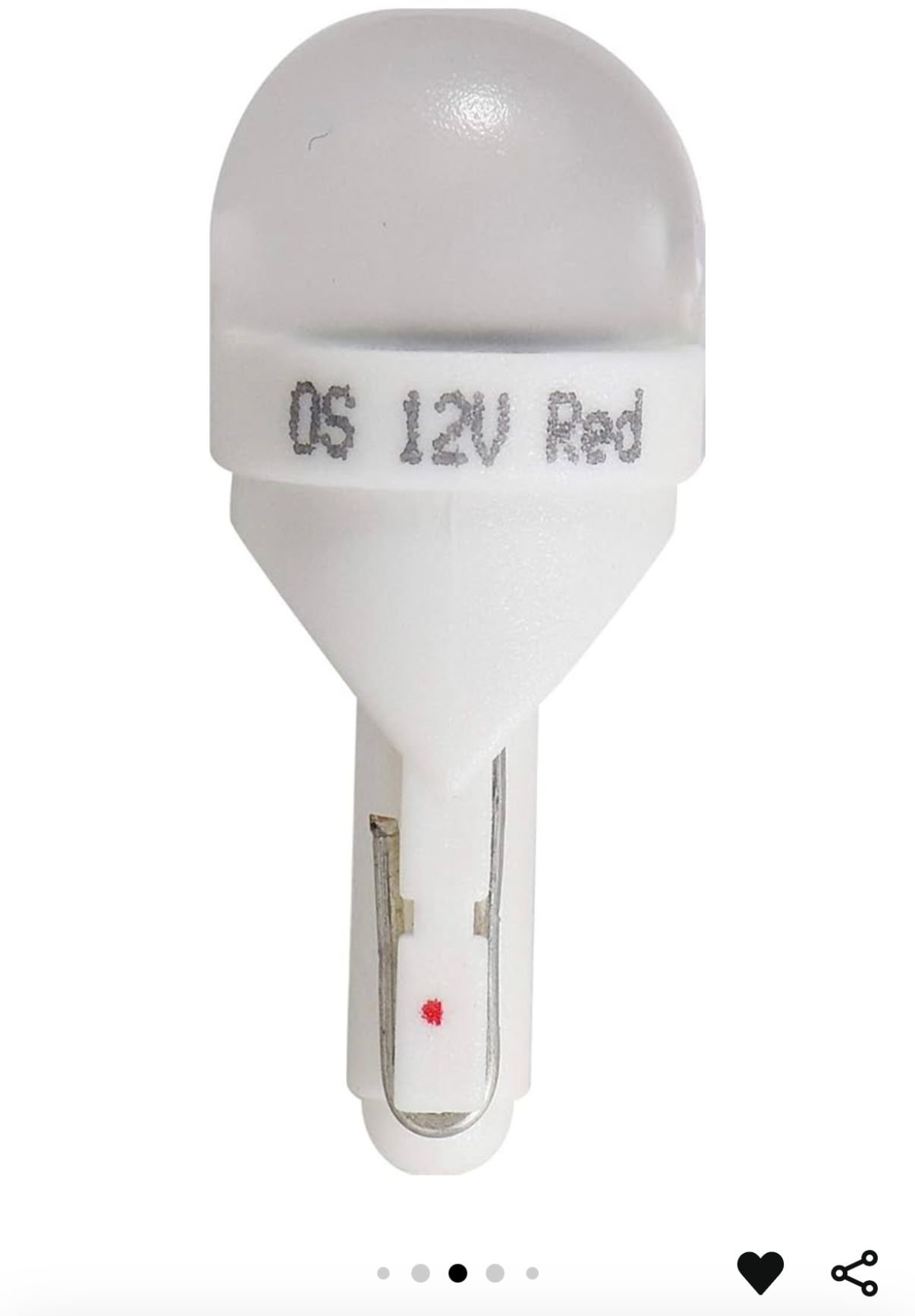

The sylvanias I used have a nice mark on them denoting the + side. Makes it a little easier when changing all the bulbs.

Lastly, any recommendations on choosing bulbs with marked polarity on them like @zray suggested?

I think all the Sylvania’s have the red dot.
Amazon USA/
https://a.co/d/3wqaxw9
see the red dot demoting the “+” side :
