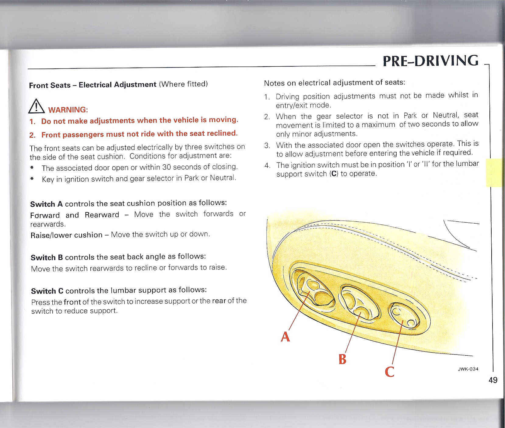

Quote "This Bracket also Tilts the Front of the Seat up a little (XKs 1997-2000 don't have separate up-down front-rear adjustments)."
While not separate switches, the seats can be adjusted up-down & front-rear with switch A.
Attached Thumbnails interior difference between x100 & x150-seat-adjustments.jpg
Correct, My statement should read XKs 1997-2000 have a Up-Down function and a Front-Rear function. The Seat Bottom can not be Tilted.
2001 and up XKs have a separate Up-Down function for the Front of the Seat and Up-Down function for the Rear of the Seat. Therefore, the Seat Bottom can be Tilted. Also a Front-Rear function.
