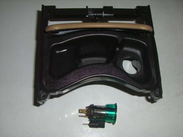

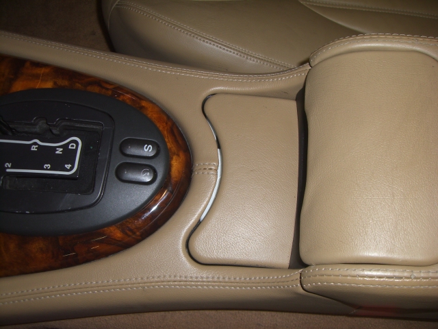

I wanted to mountan iPodin a location where it is easy to reach, and would be out of sight when not used. Since I gave up smoking 18 years ago, I knew the ashtry would be going unused. Consequently, it seemed like the best location.
I pulled the console and removed the ashtray assembly. The cigarettelighter was removed and reattached to its power source under the console.
The ashtraylayout seemed like a pretty good fit for an iPod.

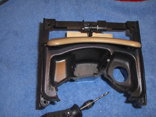

The iPod is too big to fit flat in the stock ashtray assembly, so Idremeledout some room. Most of the cutting was on the forward end of the ashtray assembly.
Having a $13,000 XK8 makes it easier tocut things up. I might be reluctant to start cutting on $30k car. Either way, this mod isreversable by simply purchasing another ashtray assembly.
On either side of the ashtry pocket, large access ports were dremeled out to fit the iPod power docking connector cordon the bottom; and the audio output cord on the top. These holes need to be wide enough to allow removal of the iPod unit.

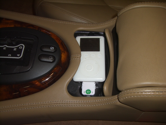

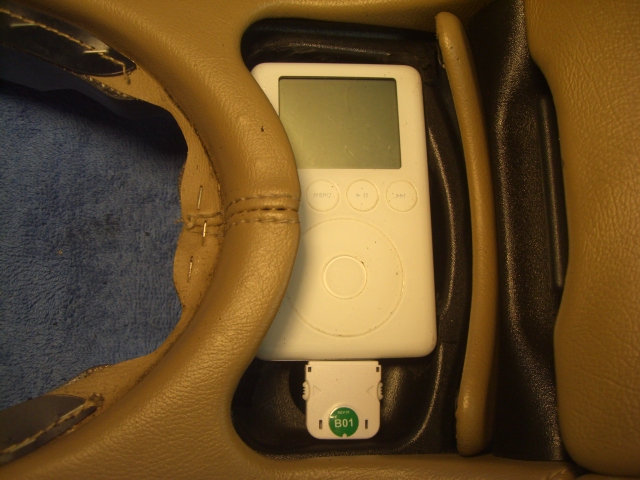

The finished product. Because the tray bottom was cut up pretty well, I added some very thin black foam backing around and under theiPod unit. This is both cosmetic and provides some insulation for heat and sound.
Stealth install. The iPod is close at hand and easy to use. The installalso allows for quick removal of the iPod unit. The biggestdrawback is the use of a cassette insert to deliver audio to the headunit. My 97 is a Bus-M and does not support the Alpine aux-input for MP3 players. Hey, we'll figure something out later. Gordo
