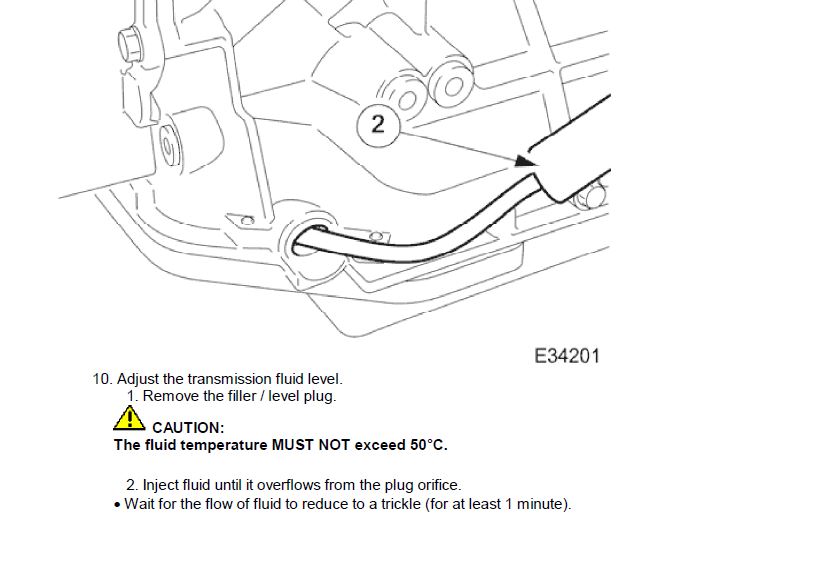

The shop manual outlines checking the transmission fluid as follows.
1. Bring the transmission oil up to operating temperature.Take a short drive.
2. With the vehicle elevated and the engine running. Remove the transmission fill plug.
3. If there is a trickle of oil coming out then it is at level. If there is not then add fluid until it trickles out and the shift the transmission from P to R to D back to R and then to P.
4. Continue adding until it is a small trickle for about 1 minnute and then refit the plug.
I have attached a picture of the plug for your convenience.
Ride height is the quickest way to check for a worn shock mount. Measured from the center of the wheel to the lower lip of the fender should be 14.5 to 14.75 inches, Anything lower than that distance and the shock mount is wore out.
You can also visually examine the mounts for bits and pieces flaking off. The best route is to get it on a lift and visually check the condition of the tie rod ends, the sway bar links and the upper and lower control arm bushings.
