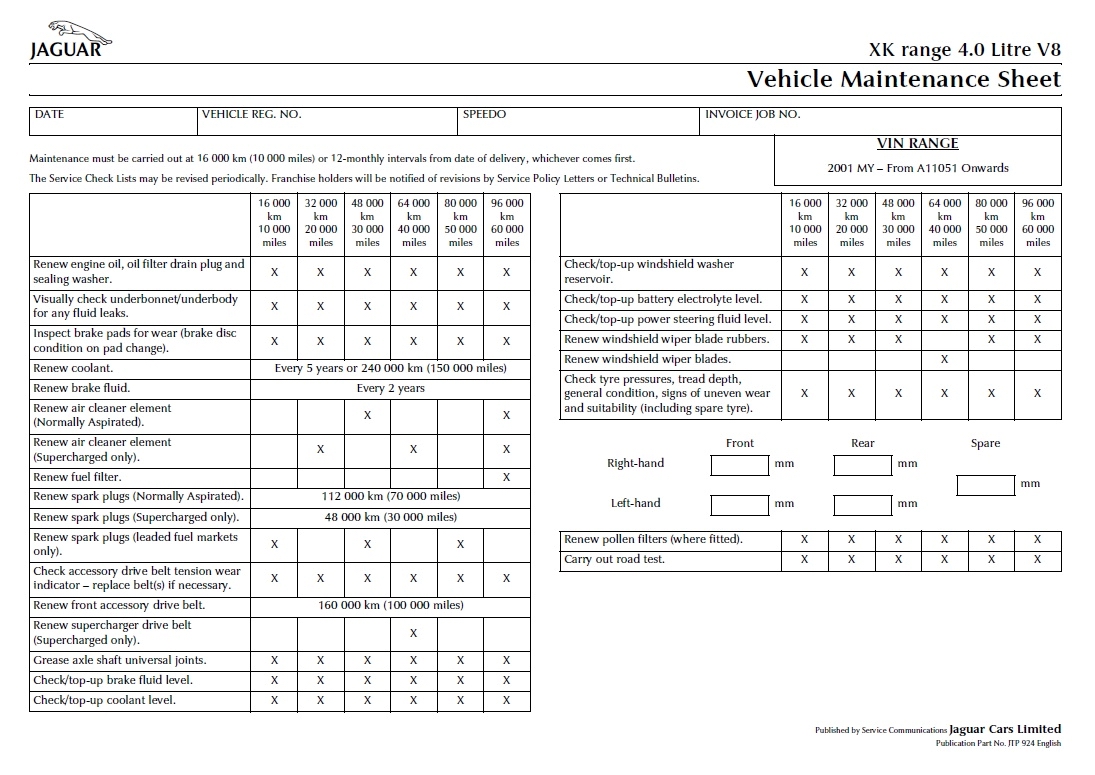

With a new (to me) car, I always do all items on the Service Schedule to baseline maintenance.
Ignore 'Pollen Filter' as we don't have them in the UK.
