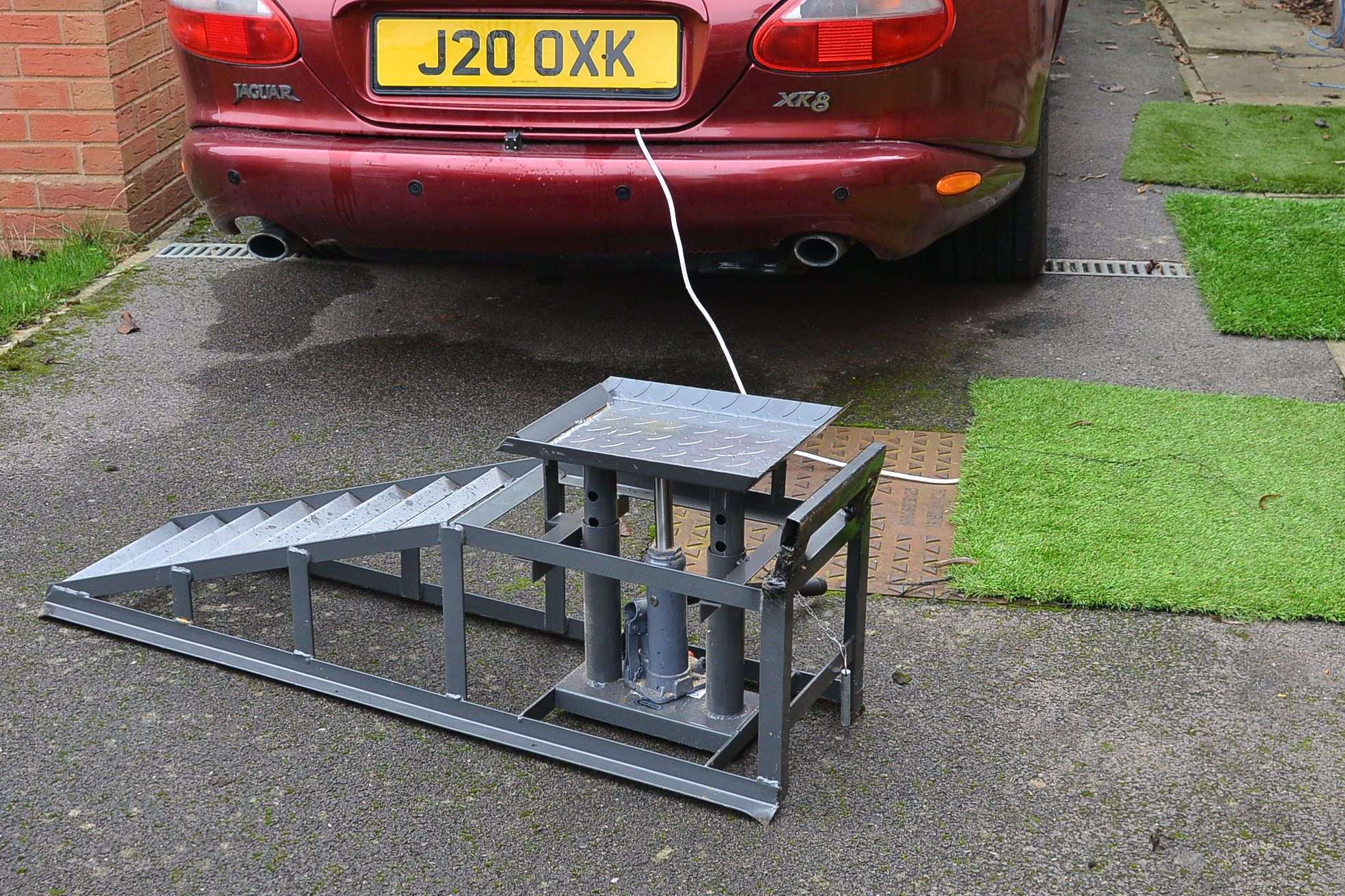

I bought two low profile trolley jacks and jack on both sides simultaneously under the front suspension bushes. If you jack one side it will lift the other .not a good idea.
I also have some high ramps which incorporate a hydraulic lift producing a further 4 inches once you have driven up the ramps

Old Jan 15, 2022 | 08:39 AM
Pistnbroke's Avatar
Joined: Mar 2021
Posts: 2,149
Likes: 898
From: Northampton, UK

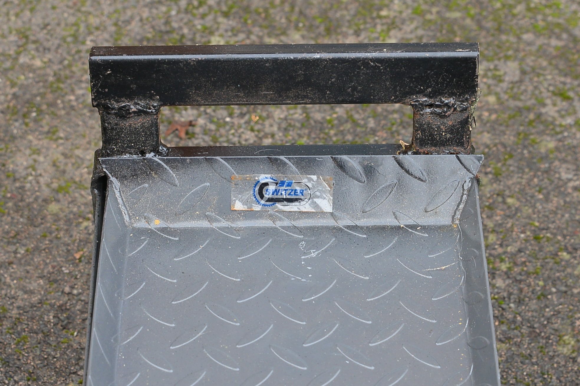

The ramps are branded Switzer and are on ebay at £149 . I did see the same at £250 but they are no problem . I did bend the end of the base down to make a point so they dont slip on my asphelt
and did not like the idea of driveing right off the top so I welded a stop to the end of the ramp. Makes a nice handle as they are heavy.
When going up forwards I place a mirror in a suitable position so I can watch the wheels go up. You can hang out for the back.
