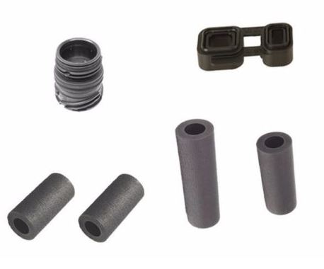

There are three seal types that I am changing out - shown in the attached photo. These are the most common to show issues so it makes sense to do those first. Logic would dictate that I should just rebuild the valve body while I have it all out and I haven't completely ruled that out yet. If I see obvious signs of degradation on the seals I am replacing, I will risk putting it back together without doing any rebuilding of the valve body but if the seals all seem solid and pliable (unlikely), I will go ahead and rebuild the valve body while it's all exposed. The only reason I wouldn't rebuild it is because I want to know the root cause of these symptoms in the event it can save someone else a lot of time and money if I am able to narrow this down.
