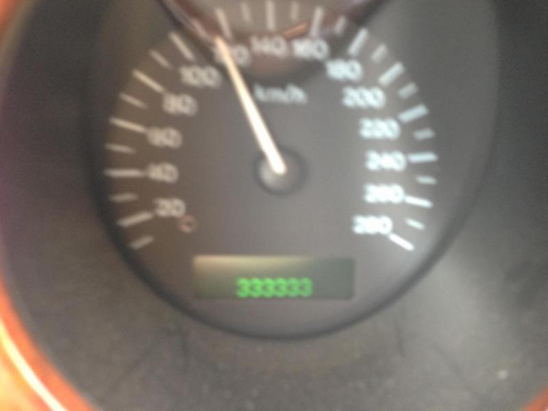

Have passed 333.333 km, and only just after the warranty period already get an issue.
My backlight of the airco unit isn’t working anymore, so am pretty annoyed that this should fail so quickly after only 12 years. Am preparing a letter to Jaguar about this quality issue LoL.
Its been a very reliable car for me in these years, although I had my share of some of the known issues, I am very very pleased!
Does anyone know if the backlight can be fixed, or do you need a new unit?
