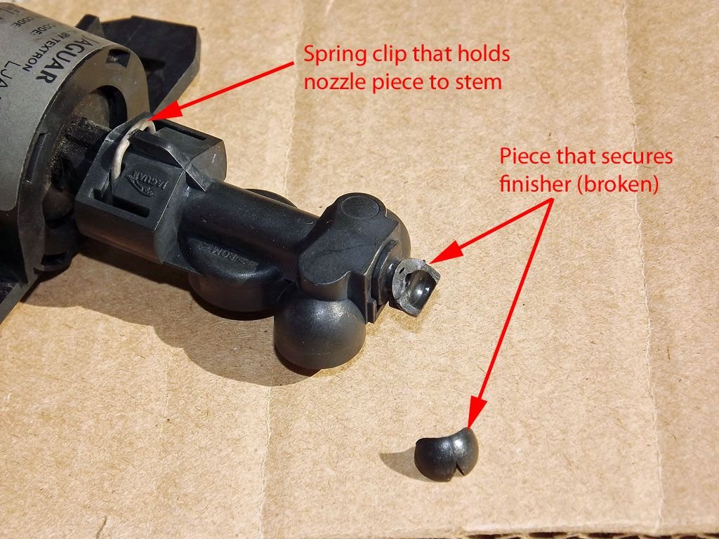

Yes it's one of the dumbest designs I have ever seen. The little nub piece at the very end of the "nozzle" piece is what holds the finisher on. What would have made some sense would be if that plastic nozzle piece could have been bought separately but not the case. You need to buy the entire powerwash unit just to get what should have been a $5 piece of plastic.

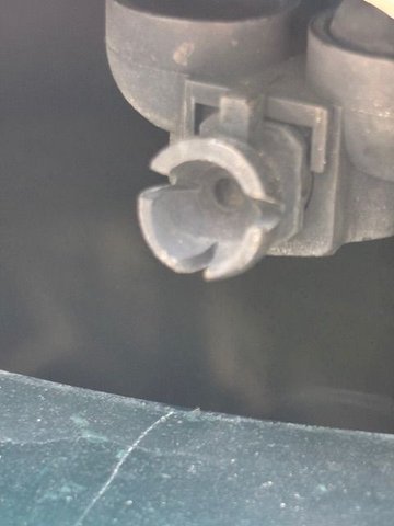

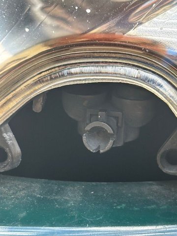

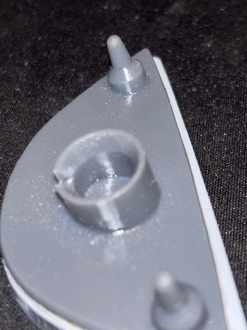

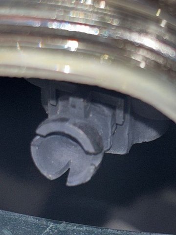

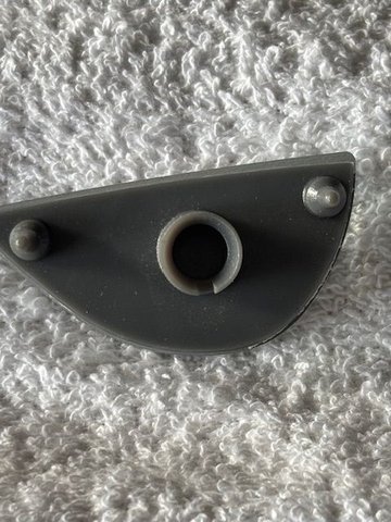

Has anyone out there actually replaced one of these things? I'm trying to figure out what it is that holds the cover to the end of the washer arm. The washer arm does not seem to have any pins or detentes or anything else into which the cover can lock. Also the cover has all smooth surfaces and, again, no pins or cams or anything else that would hold it to the arm. So what exactly is it that is supposed to keep the cover attached to the arm???????? Love???????? LOL. AT first I thought there was some part that fit between the arm and the cover that was missing but when you look at the diagram these are the way the parts are shown.
Heres the back of the cover. Theres the notch. Another view of the cover.
Here's the back of the cover. There's the notch. Another view of the cover.
Heres the end of the washer arm. Another view of the arm.
Here's the end of the washer arm. Another view of the arm.

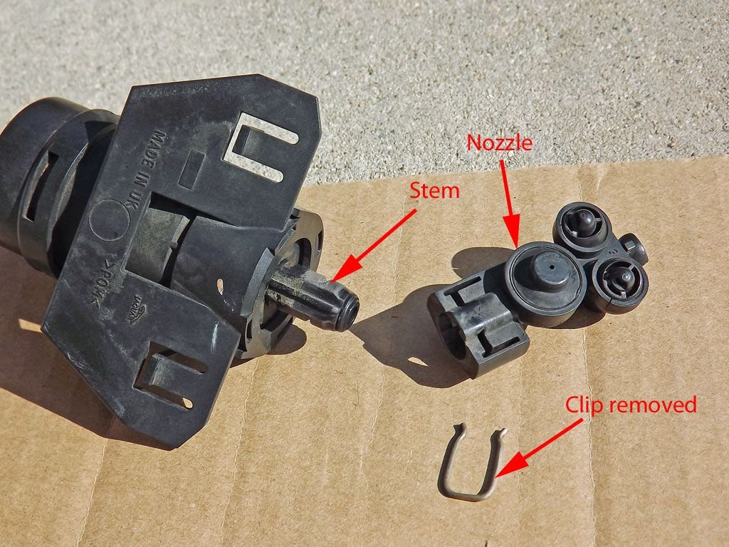

SeismicGuy's Avatar
Joined: Aug 2007
Posts: 3,431
Likes: 573

From: Orange County Califorina
Hey Seismic,
Yeah, that's what it all looks like. But I'm still trying to figure out how the cover is held onto the end of the arm. The problem I'm seeing is even if you force the cover onto the arm end, friction will be the only thing trying to hold one to the other. The hole in the cover, as best as I can tell, has straight walls so you're just pushing the arm into it. If it were wider on the inside so that the section of the arm that goes inside could open back up the maybe it would hold it on better, kind of like a ball and socket connection. I don't see anything like that in the cover I have. Have you installed one of these?
Joe
Old Sep 3, 2025 | 05:47 PM

The cover is just push on, the 3 slots in the nozzle allow the connector to close the nozzle fitting like a ball and socket. You could always drill through the assembled cover / nozzle mounting and wire it with fine steel aircraft wire.
That ought to stop the bugger from falling off at the first pothole

This happened to me many years ago and I had the local shop I was then using do the fix. This entailed needing to buy a completely new powerwash unit and replacement mirror from SNG Baratt and having the shop install (they were a bit pissed that I bought my own parts as I recall). That's when I took a closer look at the gizmo and discovered that the nozzle gismo that holds the mirror on is actually theoretically easily replaceable but was not able to track down the piece being available short of getting an entire new powerwash unit. Moreover I think it is a pita to even get to the powerwash unit and you have to remove the headlight assembly to do so.

You can get to the washer unit from underneath the car if you remove the front undertray, it's a bit awkward but hey, anything is better than removing the headlamps.
If you don't care about the washers being functional you could just unplug the headlamp washer pump and gorilla glue the new covers in place.
