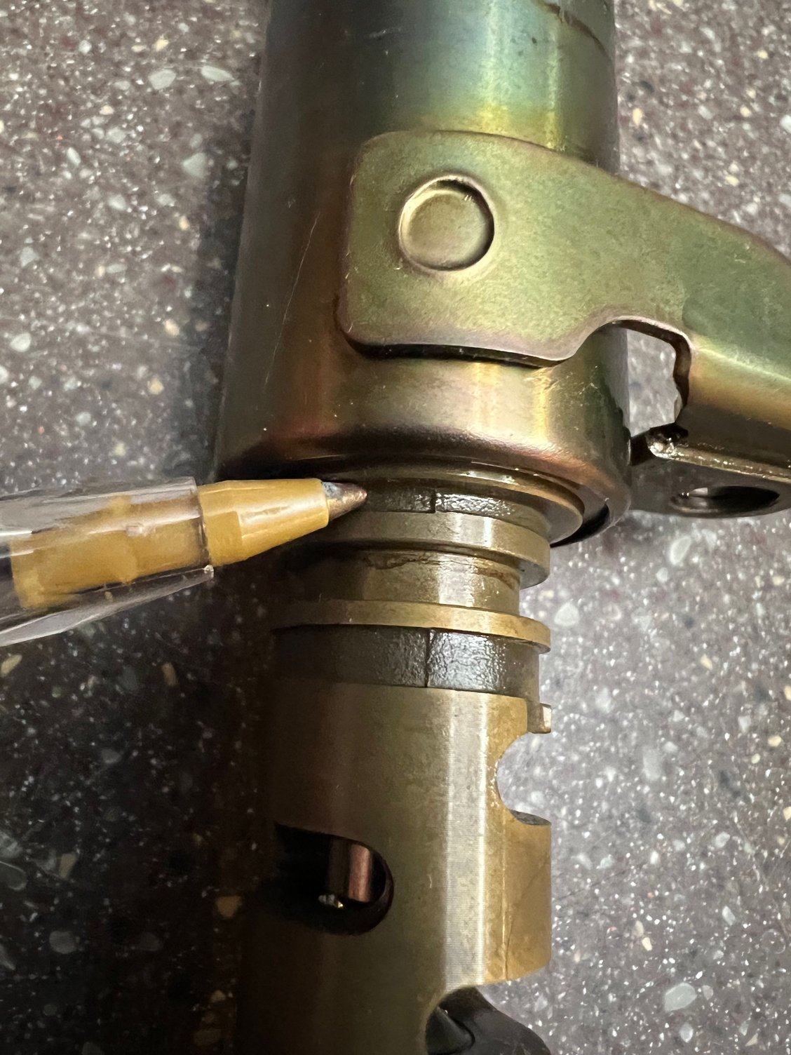

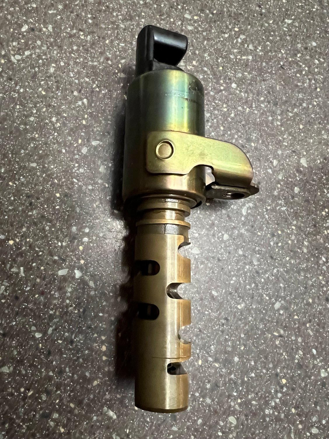

Default O-ring on VVT solenoid
Pulled valve cover and found my June 2001 engine had been refitted with third generation tensioners. Removed VVT solenoid to check. Looks like missing an o-ring. Guessing this could cause ticking by oil leaking past where the o-ring should be.
From photos on car part sites, O-ring goes here
