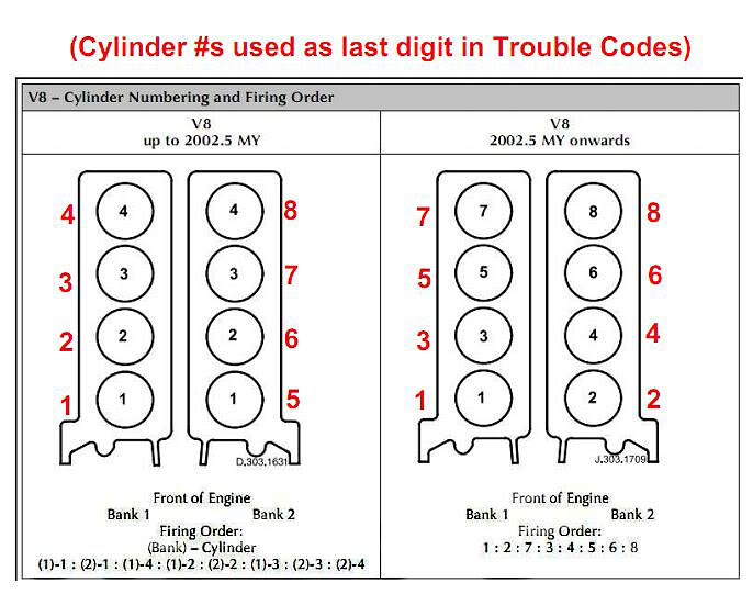

Replaced the bad knock sensor and all was well. Drove the car(first drive after knee surgery) about 100 miles and the old faithful Restricted Performance. Check the codes and P0357 coil came up. Started to go in the house and get my .357 mag. and see if we had a match! I have hunted and hunted for the sticky to tell me which bank and piston is coil P0357 and have not had any luck. Jim

Don't shoot yet!
P0357 is Ignition coil B3. Scroll down to "Engine(General)" in the sticky and there is a cylinder chart. Bank B=Bank 2 in the chart. You are Bank 2, coil 3. Make sure you look at pre-2002.5.

A bigger image:
