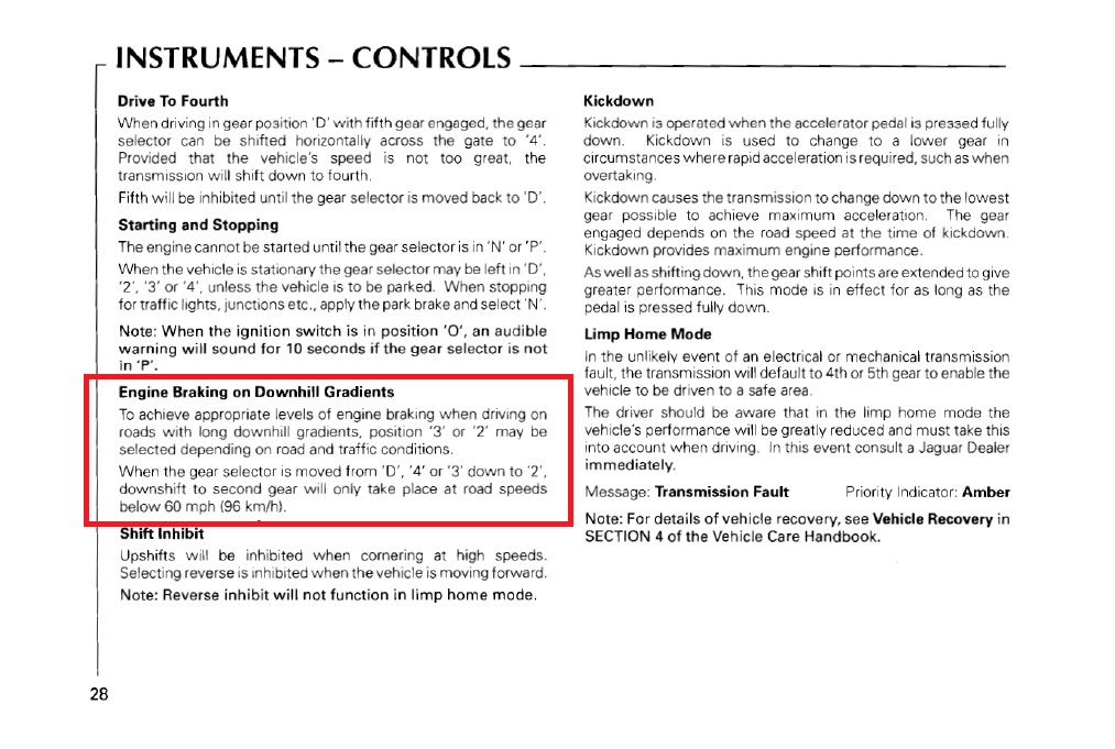

Originally Posted by cyber3d
......... Would putting it into 3 or 2 damage the transmission when going down a really long and steep hill?
Not only will it not do any damage, it is even recommended in the Driver's Handbook:
