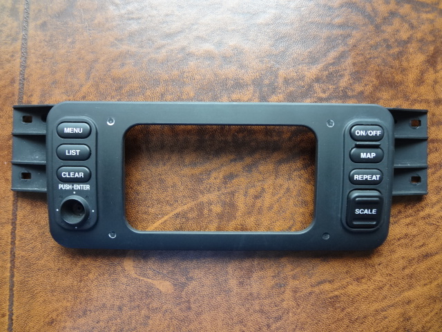

Well, I'm finally back on the forum with a progress update. I purchased a Garmin 2595LMT and found a non-working sat nav display head on eBay for $20. I've been working on the transplant assembly for the last four weekends. Should be ready to install this weekend. Lots of details and pics for anyone interested. It looks almost original, all the original buttons remain. I moved the on-off button to the left side as it's more convenient for a left-hand drive car and wired it into the Garmin switch. The blue illumination behind the buttons works and is dimmable along with the dash lighting. I loaded the original jag leaper graphic onto the startup screen. I unsoldered the female socket from the donor display and incorporated it into my hybrid so the dash wiring harness connector plugs directly in. So far, I'm happy with the results. I'm now trying to figure out how best to make the Garmin mute the radio and play Lady Catherine's (she who must be obeyed) instructions voice through the car's speakers.

Ok, here goes. This is still a work in progress and a lot went into it already. I took photos along the way to document things I did. This is the first time I've tried to upload photos here, so let me start by trying to upload a few that show the current state of this project. If I'm successful, I'll add more with explanations of the steps I've gone through.
Here are some views of the front and back of the assembly thus far...

I began by setting out some ideal criteria...
1. Look as OEM as possible
2. Have touch screen functionality
3. Ability to update maps
4. Nav voice commands through the car speakers
So, to keep the OEM control buttons, dimmable back lighting, and fitment of the new sat nav to the opening in the dash, I decided to find a non-working OEM display head and use as much of it as possible to house a Garmin nuvi 2595LMT. I searched for a couple of months and finally found a display head on eBay for $20. I disassembled it and found that the Garmin fit pretty well into the front bezel...
Attached Thumbnails Looking for a non-functioning Sat Nav head unit-dsc00818.jpg   Looking for a non-functioning Sat Nav head unit-dsc00819.jpg   Looking for a non-functioning Sat Nav head unit-dsc00820.jpg   Looking for a non-functioning Sat Nav head unit-dsc00821.jpg

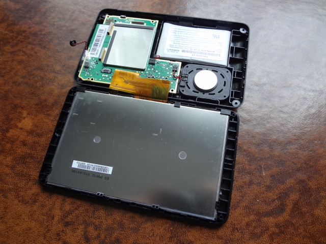

I opened the Garmin and soldered wires onto both sides of the Garmin's on-off switch and applied a few dabs of glue, from a hot glue gun, to hold the wires firmly in place on the circuit board.
Attached Thumbnails Looking for a non-functioning Sat Nav head unit-dsc00810.jpg   Looking for a non-functioning Sat Nav head unit-dsc00857.jpg   Looking for a non-functioning Sat Nav head unit-dsc00858.jpg

Soldered wires onto the speaker lugs as well. Cut two small windows in the edge of the case with a Dremel tool to exit the on-off wires, speaker wires, and the Garmin's internal mini microphone (unit has a voice activation option).
Attached Thumbnails Looking for a non-functioning Sat Nav head unit-dsc00865.jpg   Looking for a non-functioning Sat Nav head unit-dsc00864.jpg

While I had the assembly apart, I moved the original ON/OFF button from the right hand side of the display bezel to the left hand side to make it a little easier for the driver of a left-hand drive car to reach. A small detail; but I like the little difference it makes.
Attached Thumbnails Looking for a non-functioning Sat Nav head unit-dsc00884.jpg
