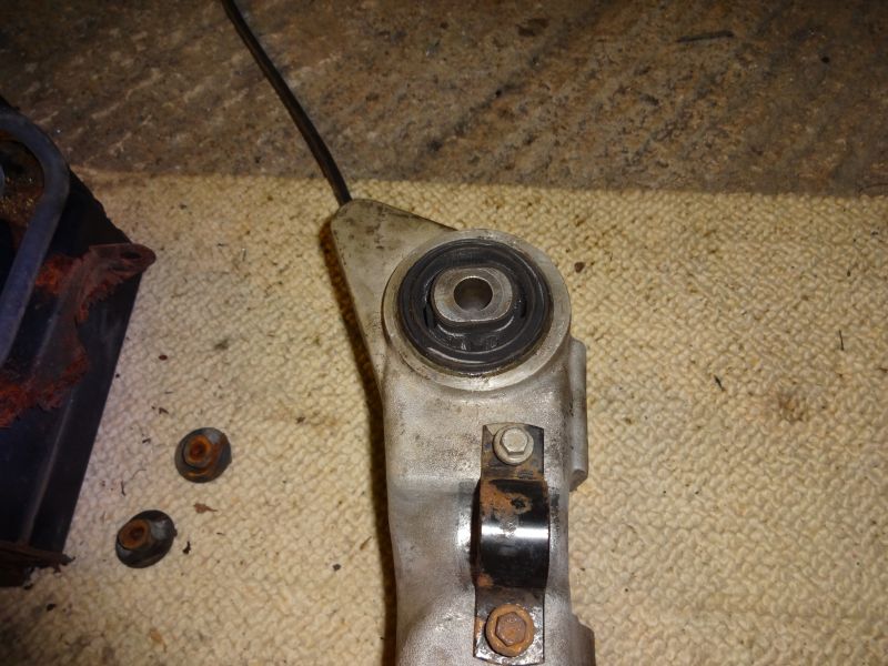

I picked up the sub frame from jag a few days ago with the new front bush pushed in, they charged £100 for the job, just had to suck it up.

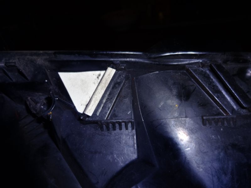

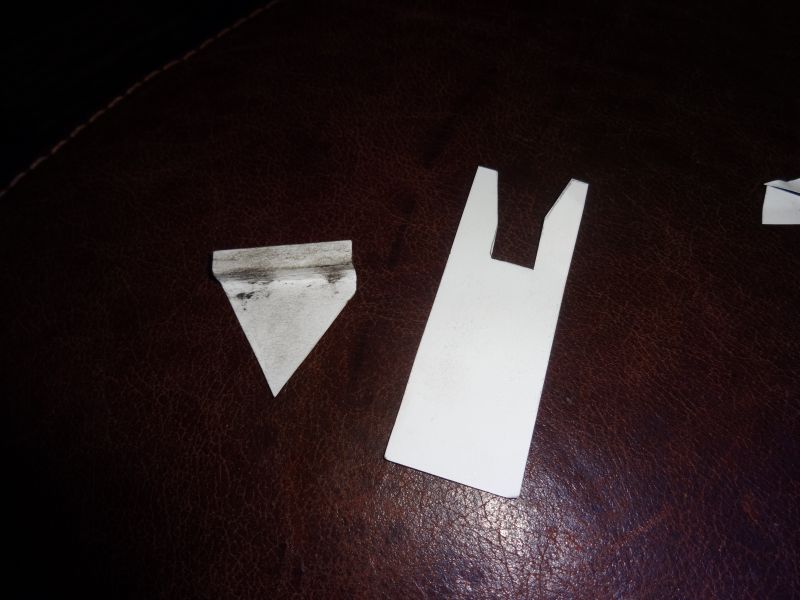

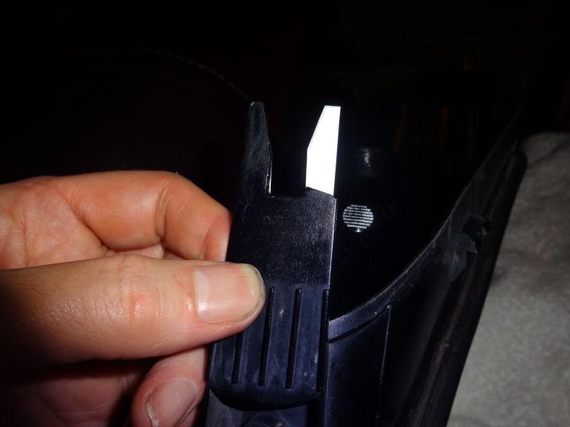

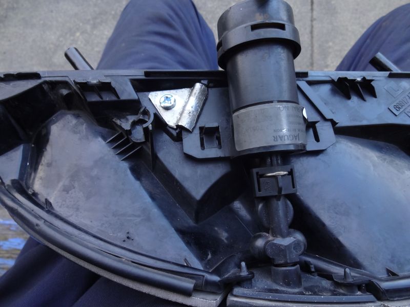

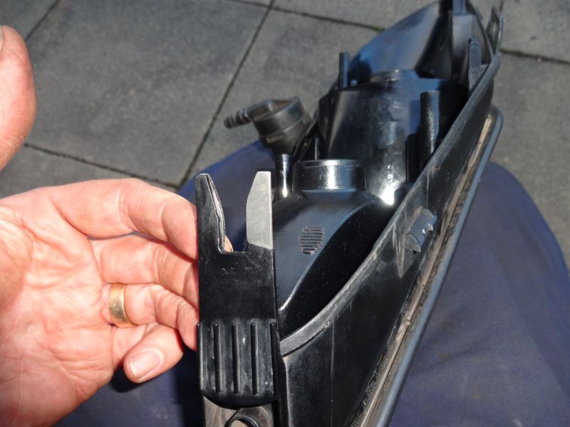

Anyway, on to the headlamp repairs, first, a few paper templates.
This is the locating slot for the headlamp cluster.
This is part of the slot that is used to hold the healamp washer piston/sprayer.
I'll cut out repair sections from 2mm steel plate and glue/screw into place.

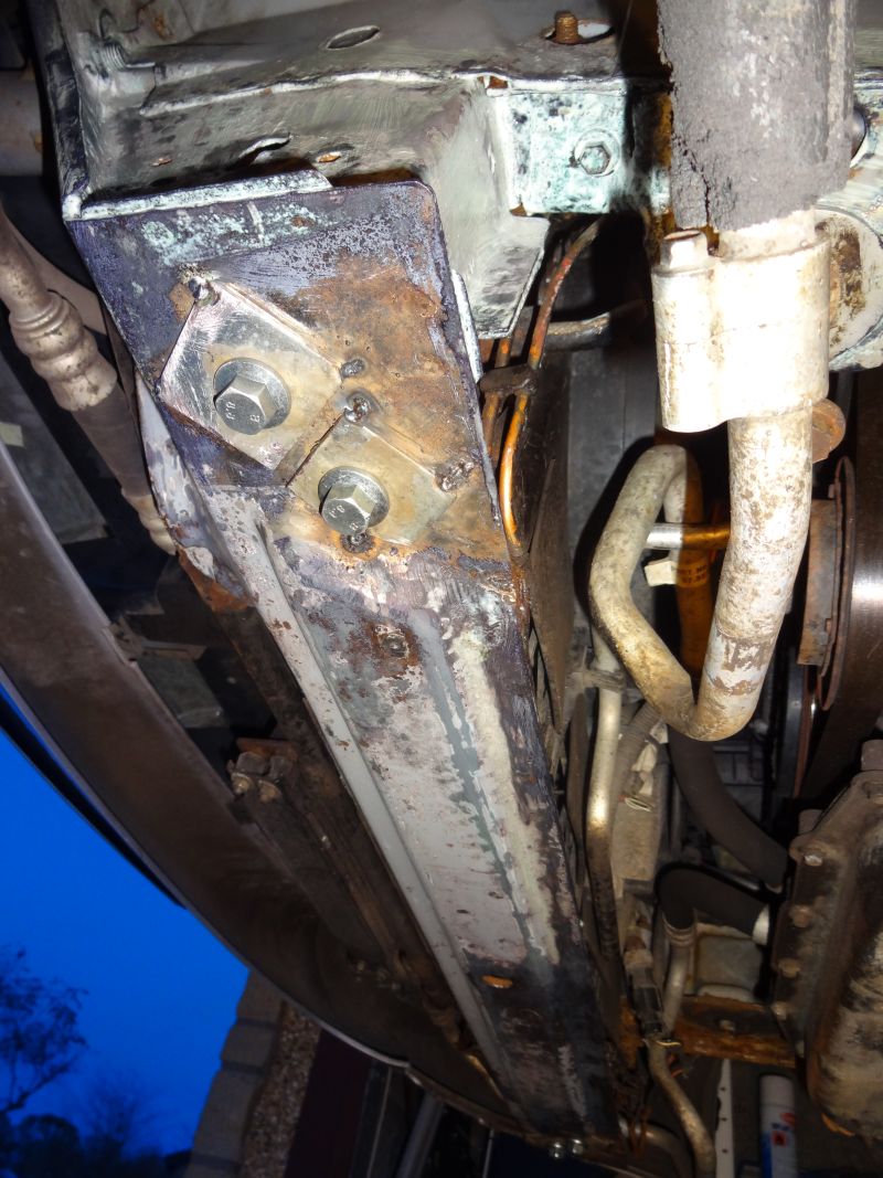

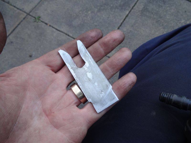

The first metal repair fitted.
The fork cut out.
I will glue this in place.
I also tacked on the second pair of nut plates, the positioning looks good.

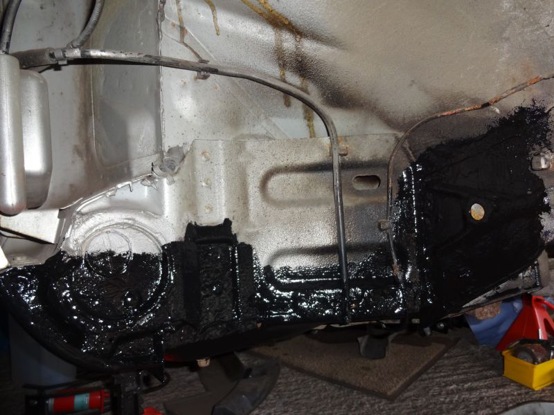

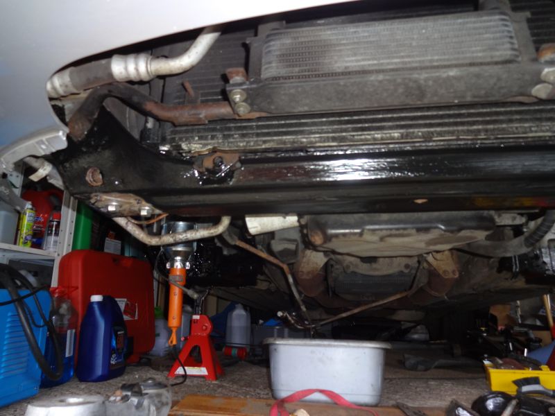

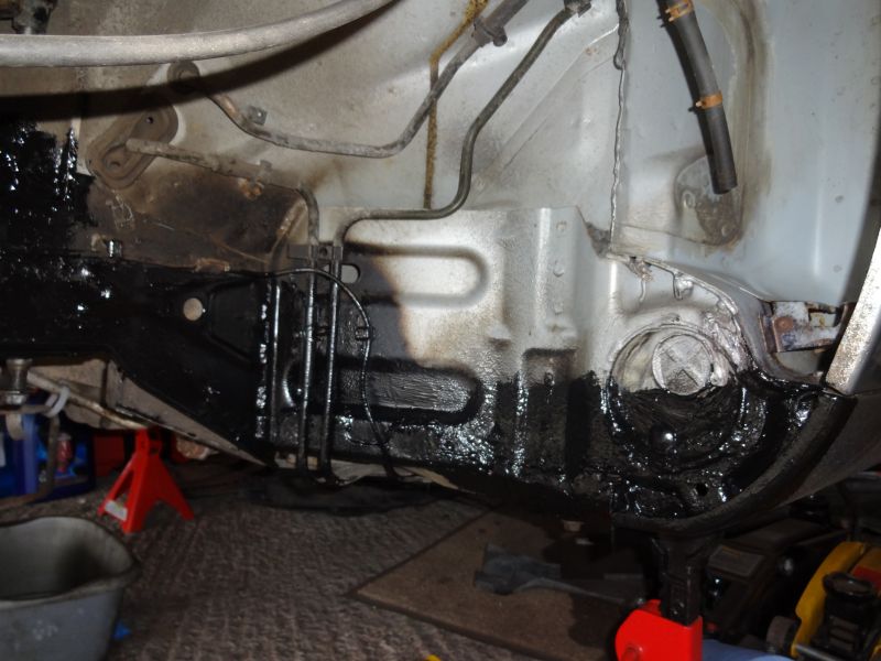

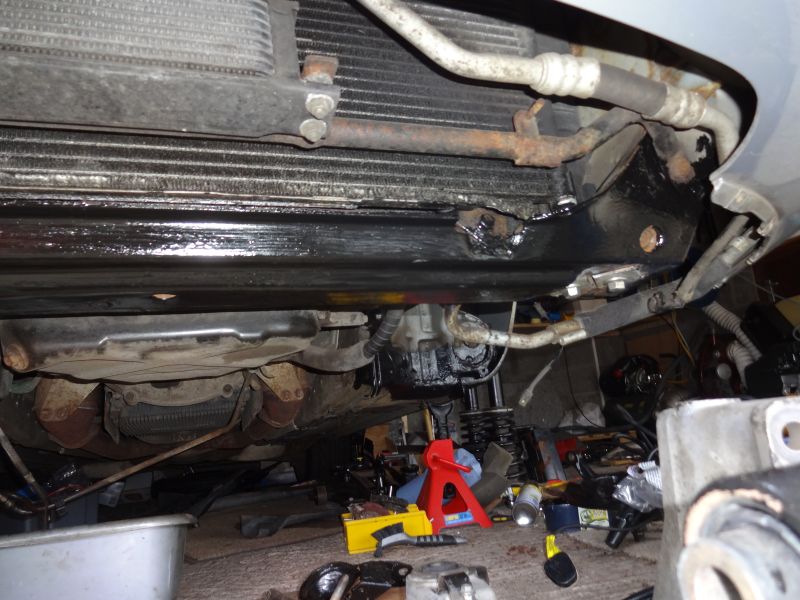

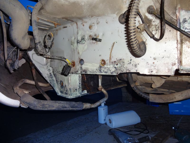

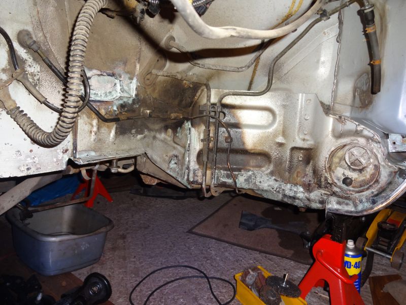

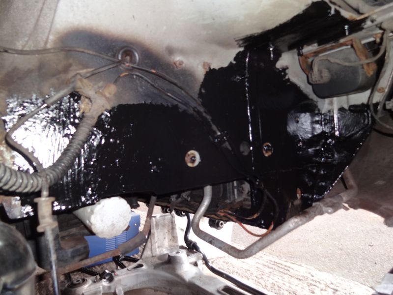

Did an hour or so of wire brushing, washing with engine degreaser on this side of the car then treated with rust converter.
I'll do the other side tomorrow night then paint with epoxy mastic at the weekend.

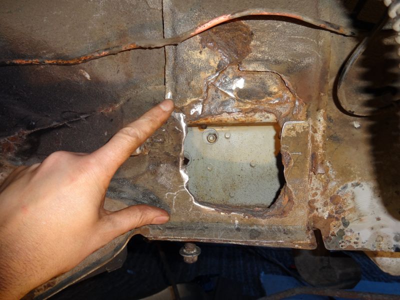

AAAAAaaaaaaahhhhhhhhhhhh!!!!!!!!!!!!!!!!!!!!!!!

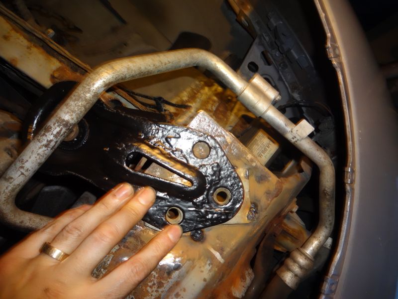

Started wire brushing the other side of the car tonight and found this.
Attached Thumbnails Loud clunk from front left when turning, getting worse...-suspension157.jpg

How very considerate ... a handy access hole for the single nut! And it's not even rusted.

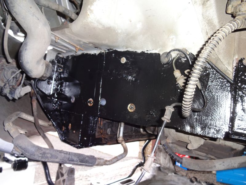

I'll call Davy the welder in the morning and persuade him to come back out.
Anyway on with the painting with Rustbuster epoxy mastic.
