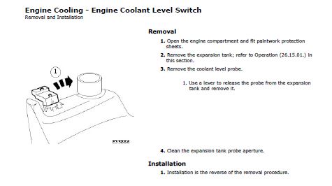

The level sensor is located on the bottom of the tank. It can be removed and replaced without loosing any fluid. It is mounted in a tube that is part of the tank. Attached is the picture from the shop manual. You don't have to remove the tank to remove the sensor. Just rotate it as shown. Also attached is a parts diagram for the sensor from SNG Barratt's catalog. You can use the listed part number for price comparison.

Thanks for the info. I ordered one from Barratts. It looks like the switch is pried out and the new one pressed in. Any idea how hard you have to apply pressure to install the new sensor? Can you press it in by hand?

Yes - it is held in by friction - nothing more. Sometimes the problem is that the sensor has started to slide out therefore giving a false trigger point so you can see how relatively loose it is.
