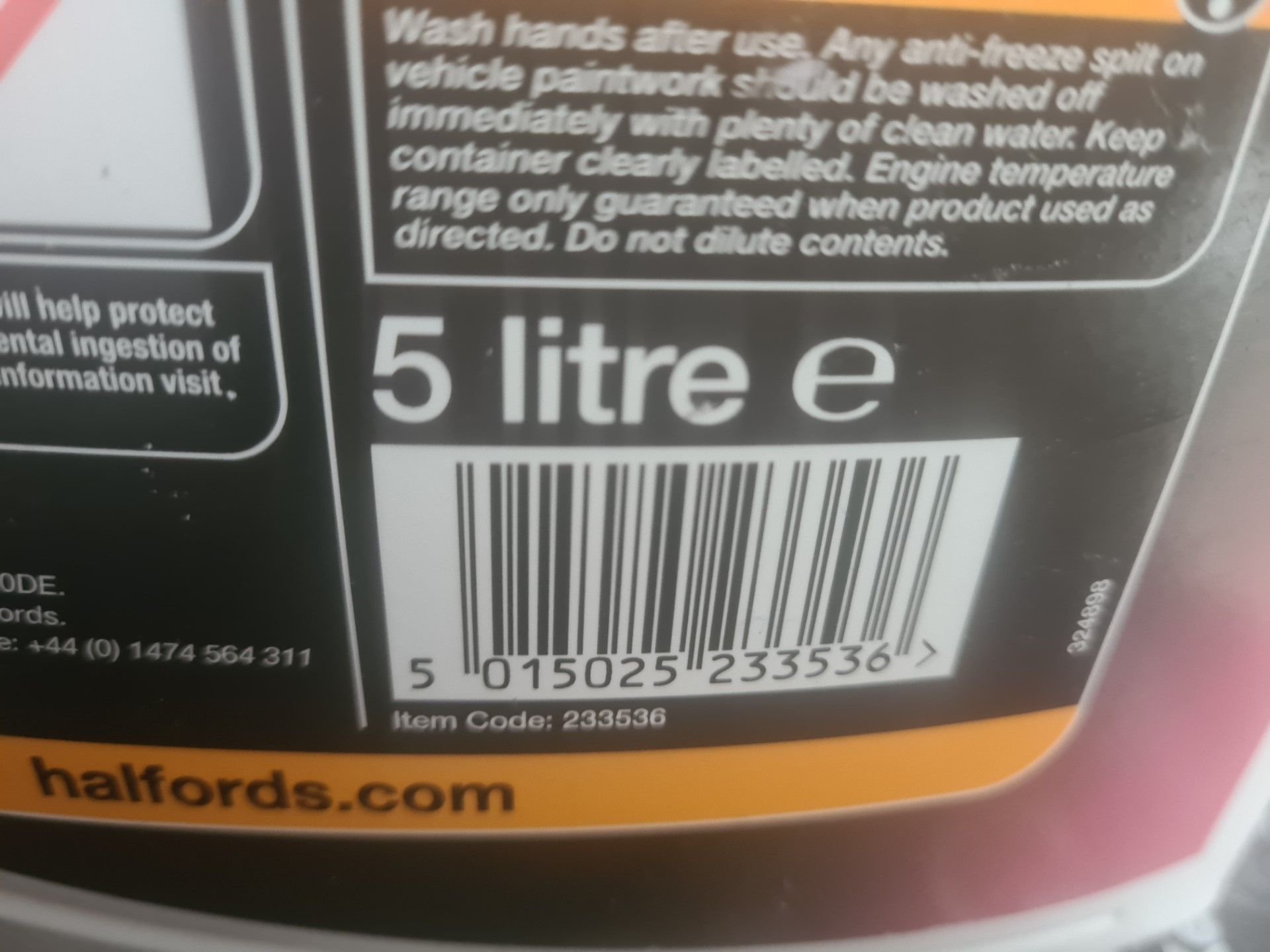

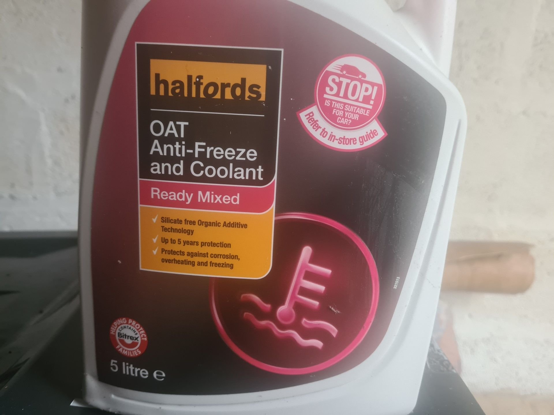

Many thanks again for all the replies - funnily enough, I've just found a bottle of pre-mixed 50/50 OAT coolant from Halfords that I bought for my diesel XF last year but didn't end up needing.
As far as I can tell, this coolant is the same as the correct Halfords one I mention in my first post above apart from it is pre-mixed 50/50 rather than concentrated.
Can I just double check that this pre-mixed coolant will be ok for my 2003 XK8? I've attached a couple of photos.

RichardS's Avatar
Posts: 1,352
Likes: 810
From: Evesham, Worcs, UK
Yes, that's the same stuff as the concentrate .... it's just diluted already.

That's excellent, many thanks Richard, I'll top up the coolant with the diluted one tomorrow.
Sorry to make such a fuss over such a simple job but I'm a bit paranoid about adding the wrong stuff! I keep hearing that it has to be Ford spec M97B44-D but in a nutshell, as long as it's OAT and red/orange it should be fine.

RichardS's Avatar
Posts: 1,352
Likes: 810
The only disadvantage with using the red/orange stuff is that if the stuff already in there is green, blue or yellow rather than clear, you usually end up with a dirty brown colour which looks ugly, particularly if you have a translucent tank. which we don't. The only solution to this is to drain and flush out all the old coolant and refill with the new colour. This should be done every 8 years or so anyway so, if you don't know when this was last done on your car, it would be worth doing it once you have ascertained that there are no leaks.

zray's Avatar
Joined: Jan 2018
Posts: 3,751
Likes: 2,343
The orange is the right coolant. But as mentioned, you might want to use the type as what is already in the system. Mixing to distant types of coolant can result in a plugged up radiator.
the current coolant could be anything, but hopefully it’s the proper coolant already.

x2008type's Avatar
Posts: 36
From: UK
Thanks again, the current coolant looks orange so I'm sure that the Halfords OAT will be fine.
