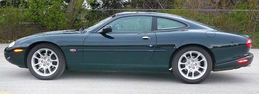

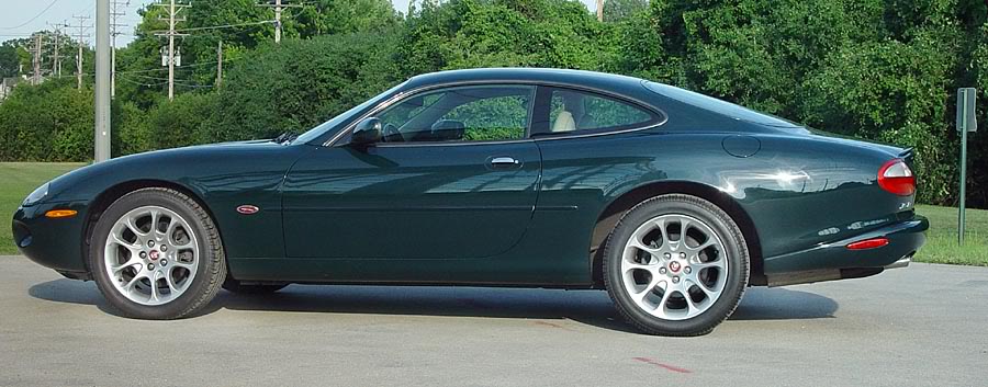

I had the Mina REAR Lowering Springs installed today at Jenkins Volvo-Jaguar (Milwaukee, Wi) and the results are very Satisfactory.
The height of the Rear Arch to Ground is now identical to the front dimension. The rear sits about 1.25" Lower than before.
The clearance between the top of the Tire and the Arch is actually 1/4" less at the Rear than at the Front now (but, of course, the rear tire is slightly greater in diameter than the Front).
The Ride Stiffness is Unchanged. The Mina Springs are "Progressive" and will stiffen at High Vehicle Loads.
Cost: Mina Rear (only) Springs. $250 inc. Shipping.
Labor: 4hr @ $115/hr----------- $460.
Total:----------------------------- $710

The before shot shows just how high US XKs ride. I may be wrong, but I think European models are more like the after shot straight out of the factory. Definitely a must-do mod.
