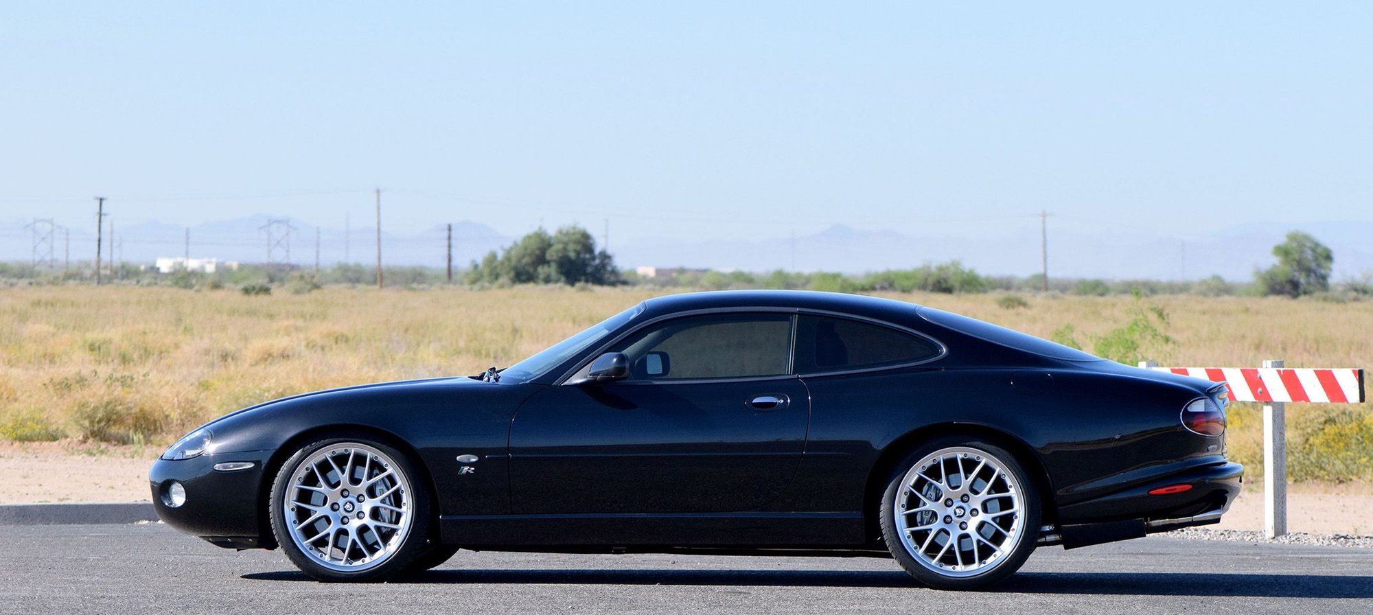

Adamesh Springs
I like them a lot, didn't hurt the ride (bushings and wheels matter more). My original front springs were sagging already so the front didn't change much with the new, "lower" spring. The back is down by about 1" which is (I think) where the car should be.

Looks great!! I love the Perseus wheels too! Almost as much as my Detroit's (yes I know they are more common!).
I think I agree. The ride height reminds me more of an E-type series 1 ride height.

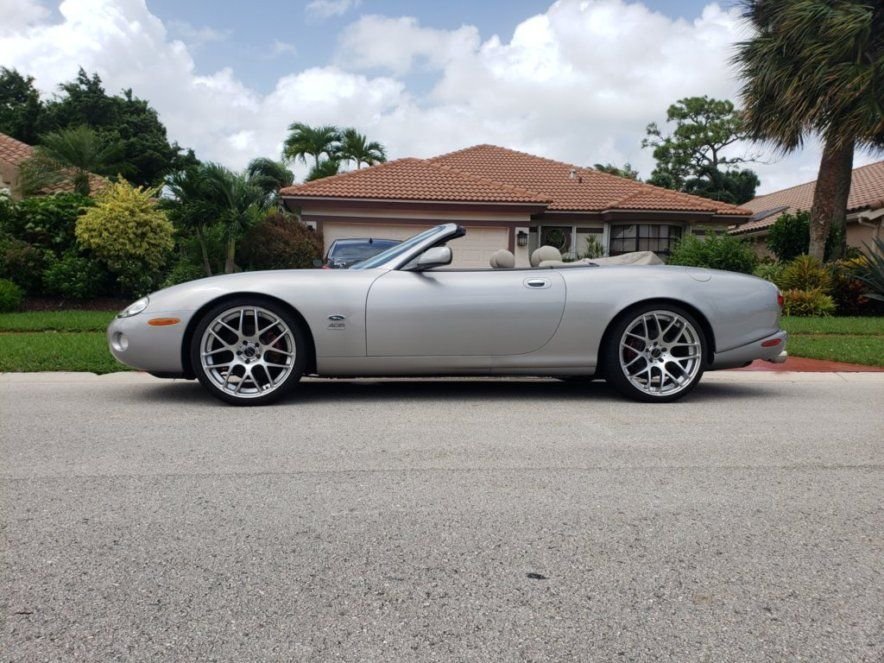

H&R Springs
Mine might sit a tad lower than Charlie's car (which is a BEAUTIFUL car, by the way)... I am not sure what the overall change was, but I am happy with these springs.

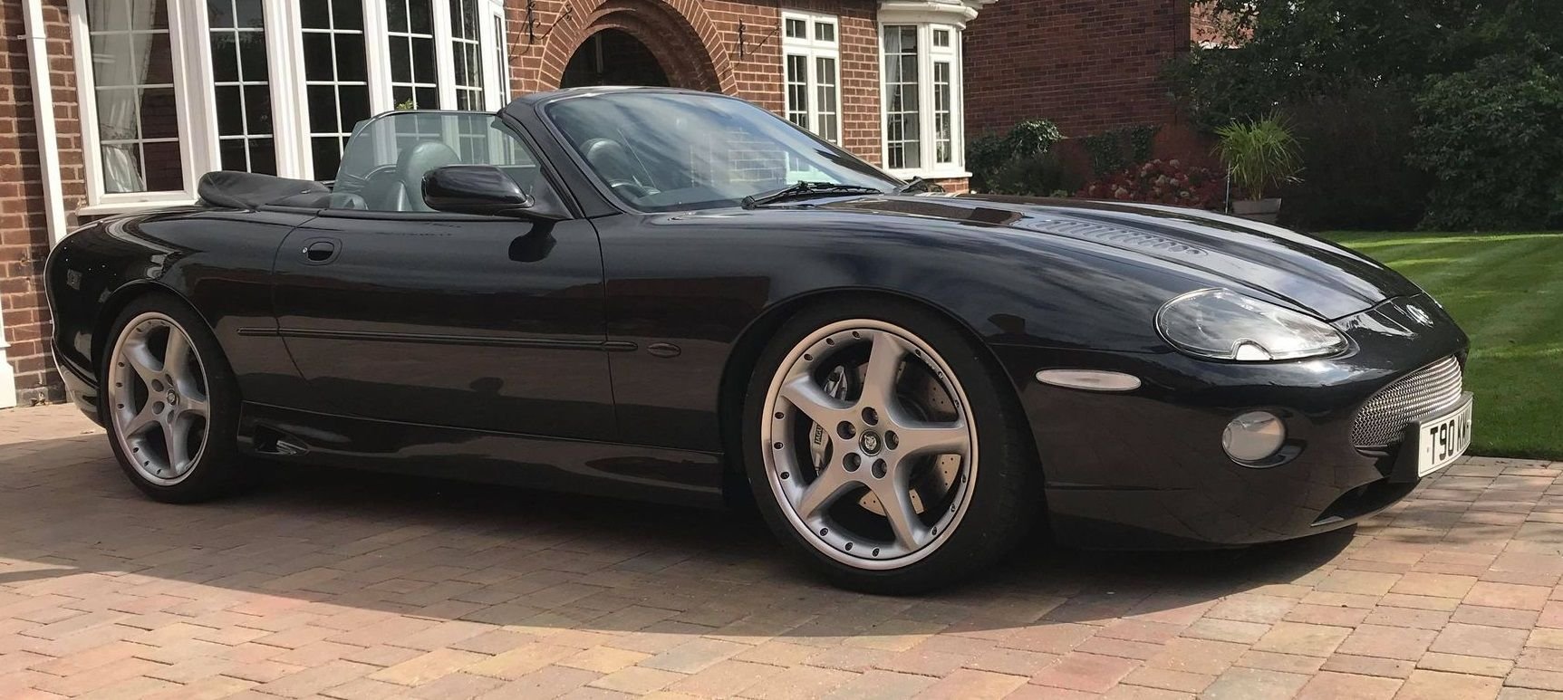

Mine was lowered using Arden springs, UK agent at the time was Racing Green Cars who also fitted the Arden body kit etc. I don't know how much lower than stock it is but I have no problems with the 20" wheels
