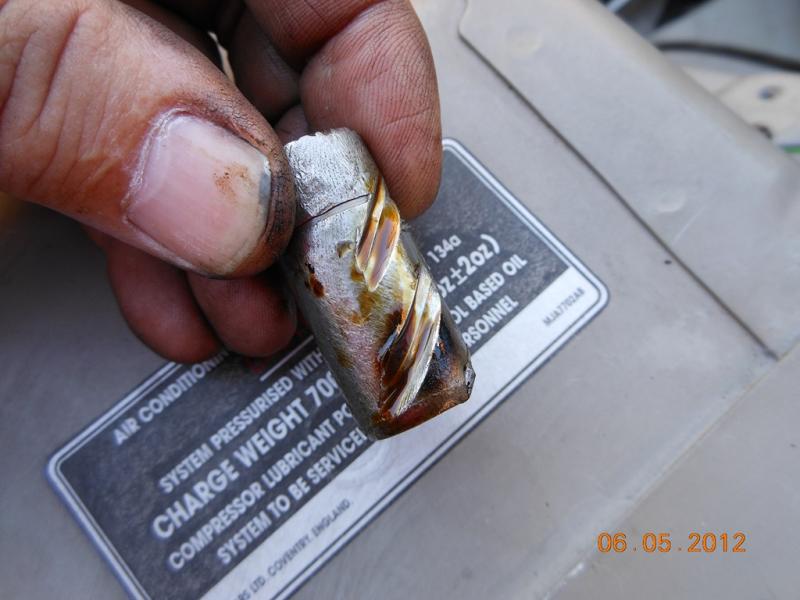

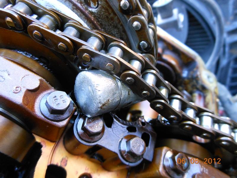

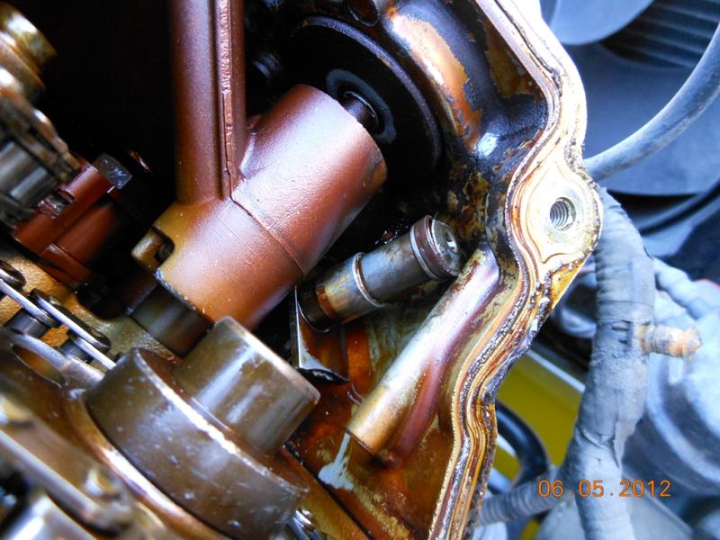

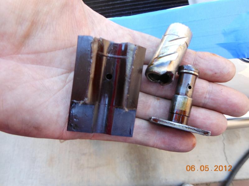

check this tensioner out, she was a banging around.... 1998 with 124,991 miles on original parts..

Every time I see pics of the tensioner issue I am nonplussed as to why the engineering team at Jaguar would use such inferior materials in so critical an area of the engine. These parts are not a big weight issue nor a major cost issue. Most plastic/polymers do not fair well when bathed in oil, subjected to high temperatures and further insulted by a varying vibratory load and, if you study the design...potential shear.

I feel the so cal on-ramps with spirited right foot for most the blame. It happen on the way home from work, around 50 miles is all.
It sounded like an old Ford farm truck with a rod knock. the rocker cover was also messed up some, I fixed it with JB weld.
