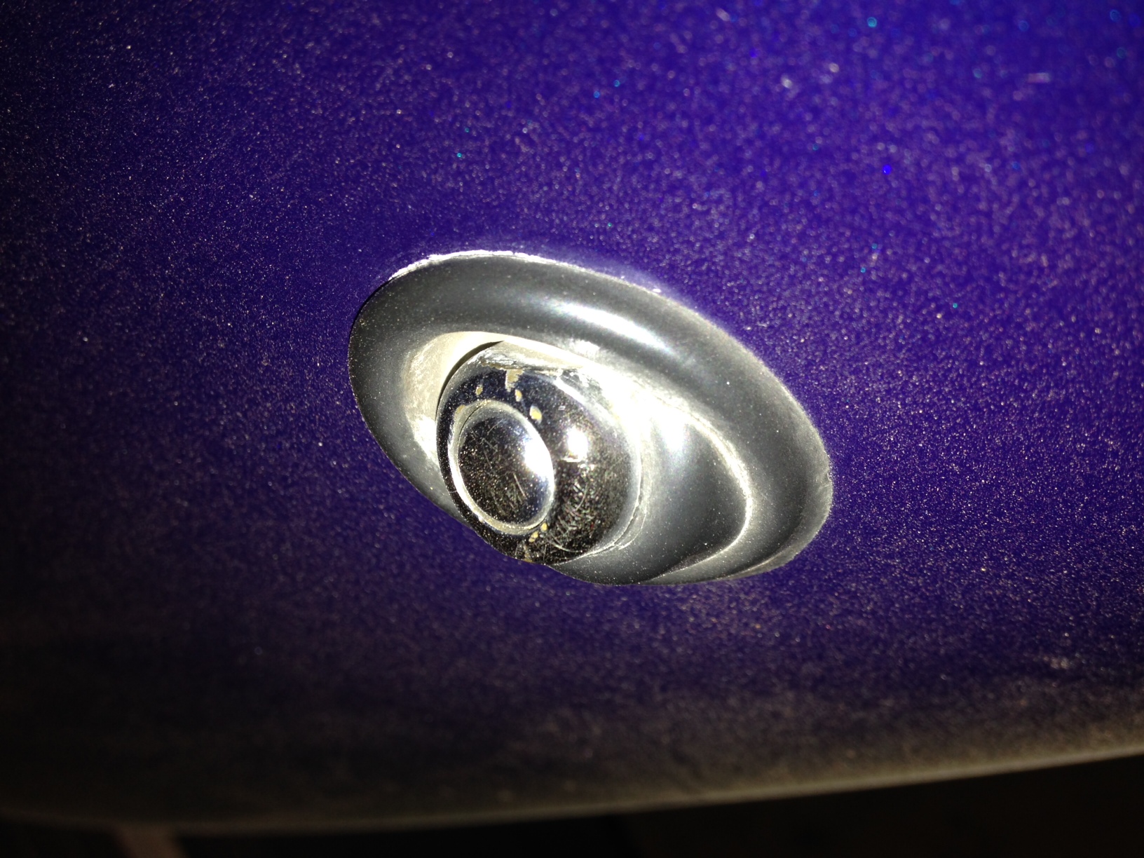

How about that, I got a check from the garage, and it cleared! First time for everything. So lucky enough, I only had to replace the mast. The motor works fine. However, there is a gap between the antenna mast and the rubber book that it passes through (through the fender). I'm wondering if I'm missing a piece. Looks like a place for rain water to go.
Anybody have a close up photo of their XK8 antenna in the down position? Much appreciated if you could text me a pic 631-806 two one five two.

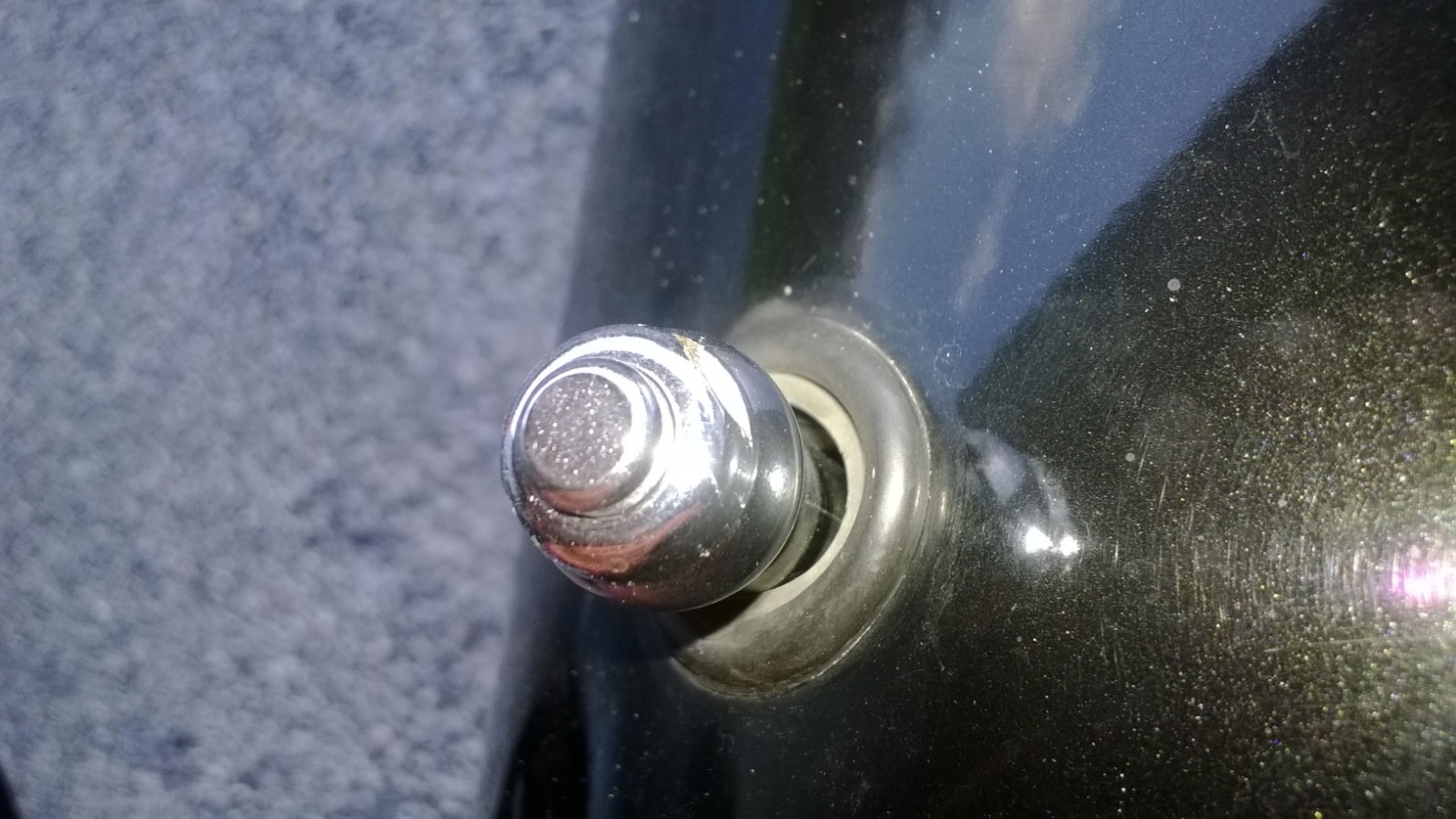

Old May 2, 2014 | 07:42 PM
Jag#4's Avatar
Joined: Feb 2012
Posts: 2,997
Likes: 714
From: Waco, Texas, US
The one on mine sits a little more flush.

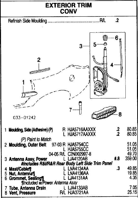

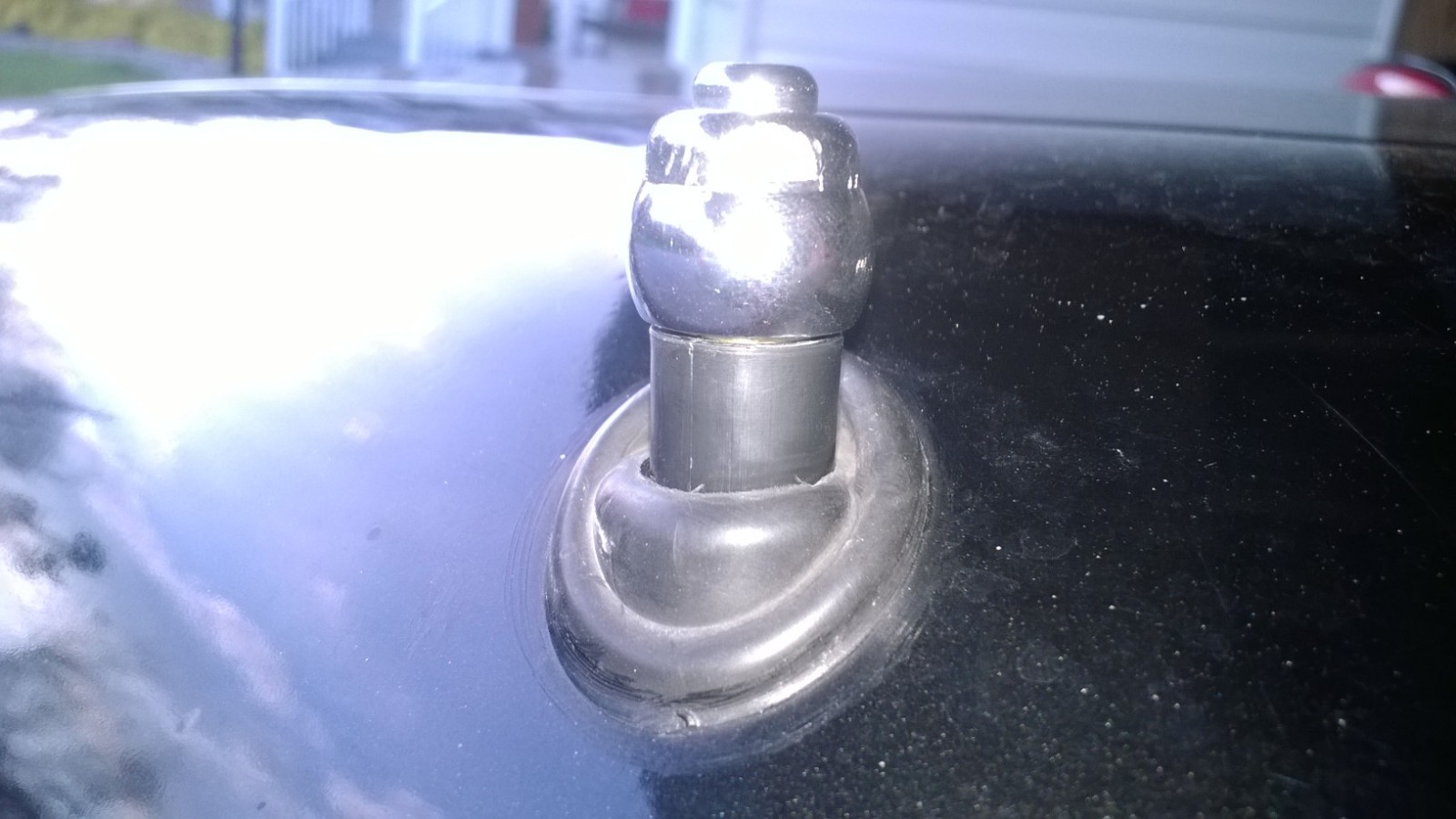

Looks like you are missing the antenna ball nut which fit on top of the grommet to finish it off & make a good seal. Follow this link:
Jaguar ANTENNA BALL NUT - LNA4136AA
Here are some pics that might help.

I've got the antenna nut, it's just up to high.
I think the entire motor assembly must have been pulled up an inch or so. You can see my antenna nut is too high, showing off the black tube the mast slides into.
I'll take a look in the trunk and see if I can loosen the motor mount, and slide it back down to push the exterior nut up tight to the rubber boot and make it water tight.
Old May 2, 2014 | 08:44 PM
bsprowls's Avatar
Joined: Mar 2011
Posts: 124
Likes: 37
From: Naples, FL
I see that now. When I first looked, I thought that the nut was missing. Anyway glad that you are back on track with it now. Your analysis about it being up too high seems correct.
