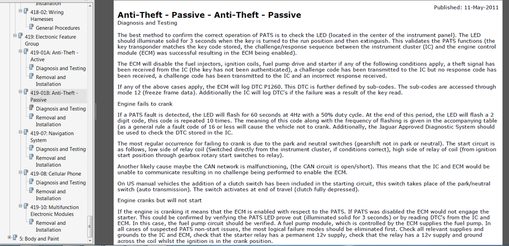

It's in the year 2003 XK8 & XKR Works Manual section 419 -01A (3rd para from the bottom) -------->

Posts: 121,131
Likes: 6,653
I've a feeling that may just be a cut and paste job from another document.

I suspect you are correct - but I asked the question just in case someone has a manual XK somewhere.
