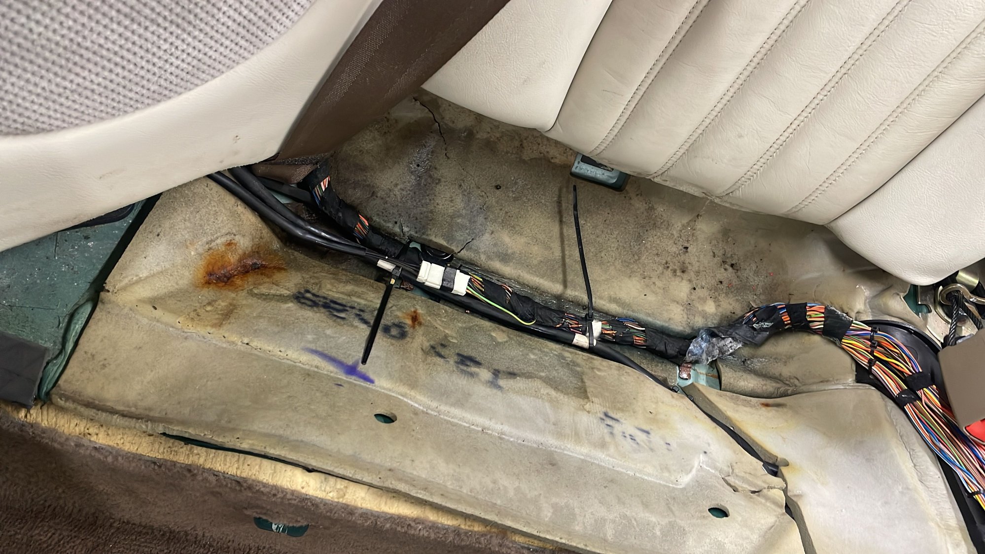

I've been a little concerned about some rust discoloration on the carpet in the rear drivers side footwell so removed the drivers seat and am halfway through the rear seat an trim (so much easier in the convertible). Sure enough there's a collection of water under the rear seat. I'm presuming that it's a poor seal and/or blocked drain somewhere. I've been reading up on other people's experience but it would be good to know if anyone has a decent set of steps to go through to identify where the water is coming in. I've not found anything but a bit of suface rust and rusted bolt heads so I'm feeling positive.
The wheels are coming off tomorrow to take them to a local wheel specialist and getting them tidied up and painted, and either fix or replaced the buckled wheel. I've asked for recommendations for colour on another thread - I was thinking of white gold but someone has just come back with pewter - that might be a little more in keeping.
While the wheels are off I'll have a proper look at the brakes and suspension components. Fingers crossed - Again!
Lots of evidence of water ingress including actual water!
