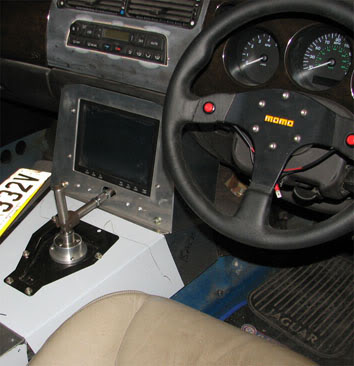

I prefered to fit mine under the vents, I dont like looking down and prefer to glance side ways and to rlocate everything else just felt like too much of a chore, its all personal preference. I fitted my track car screen low down I am still in 2 minds to move it.
A lot also depends on what you want the screen to do, I am not a fan of satnav, it is handy sometimes but not like some numpties who insist on using it everyday from home to work and back again, I dont get that!
I wanted mine mainly for music and to plug in to my OBD port, the trick is to make it look stock

LOL... Not quite, you will be lucky to hear yourself think let alone to music....... It is so I can watch what the engine is doing, my ECU runs through a laptop and I can watch how the engine is performing
