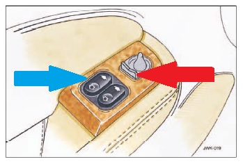

My mirror selection switch is frozen in the drivers side position. It worked a week ago and now won't budge. The drivers mirror works fine. I can't seem to find anyone with a similar issue but seem to remember somewhere on this site reading about a fuse. I found a fuse chart and can't seem to locate it. Any help would be appreciated (especially before I fork out $120+ for a switch!)

Is it the LH/RH mirror selector rocker switch (arrowed in red) in the Driver Door Switchpack that's stuck?
If so, it's likely to be a physical problem with the switch rather than an electrical issue.
The Driver Door Swtchpack controls the mirrors through the Driver Door Control Module. A harness link to the Passenger Door Control Module allows the Driver Door Switchpack to control the passenger mirror when the rocker switch is moved.
I had a bad experience taking a Driver Door Switchpack apart to try to fix a sticking window switch (arrowed in blue). Springs and contacts flew all over the place and I ended up getting a replacement switch! One member did report recently that his wife's nimble fingers succeeded in repairing his switch.

Graham,
Yes, that's it. I suspect you're right. However, I thought it odd how it worked fine one day, the next - frozen, with no movement whats so ever. Looks like I'm going to have to replace it. My wife also has nimble fingers, however, she'll ask to drive the car as payment. Avoiding that scenario is worth the $100+. Thanks again

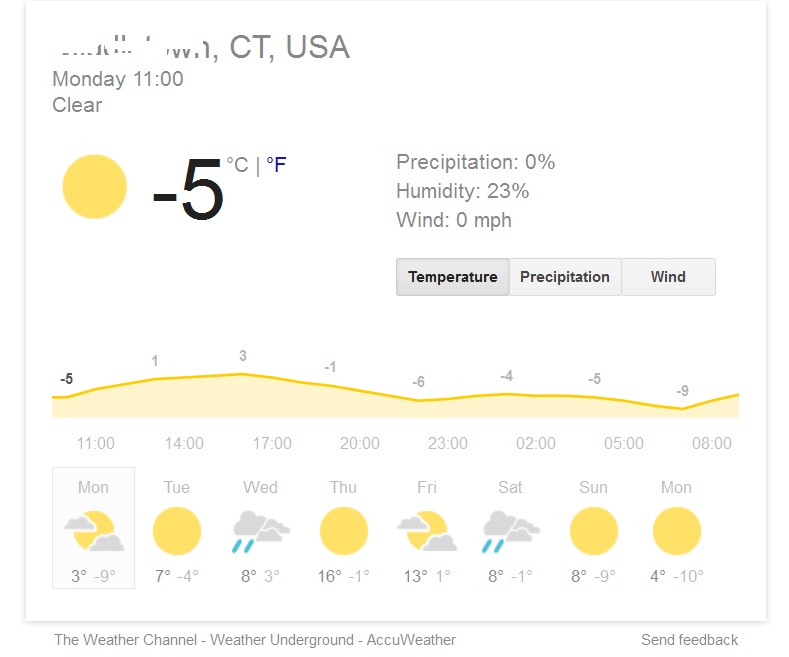

You could be on to something there. This is the weather in robert53's location now:
I've blanked out the city name.
Old Mar 17, 2014 | 10:14 AM
Jon89's Avatar
Joined: Jan 2009
Posts: 13,090
Likes: 4,748
From: Raleigh, NC
Graham,
Wouldn't surprise me at all if the cold weather is causing this issue....
