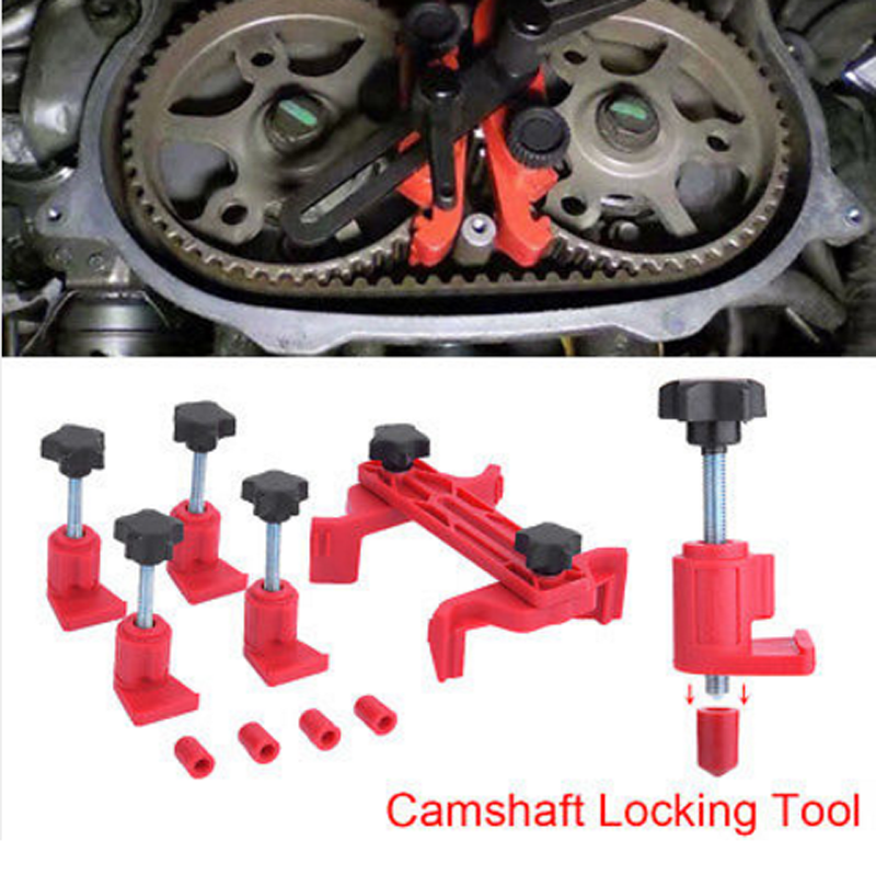

aaaaaaaaah thats the problem, anything beyond a screwdriver and set spanners is special around here l borrowed some good ones, thats not a job for screwdrivers, however well intentioned.
Yes (if the price is right) if they look something like the first pic, no thanks to anything like the second.

Here is the set I have used many times, original from Jag, except I replaced the cheap bolts with SS socket heads, and had a piece welded onto the setting wrench for additional strength.
I don't have the VVT wind back tool, but have never had to use it. The new tensioners will come with pins in them, and I use a screwdriver instead of the wedges which always seem to slip out..
$ 140 shipped in the US.

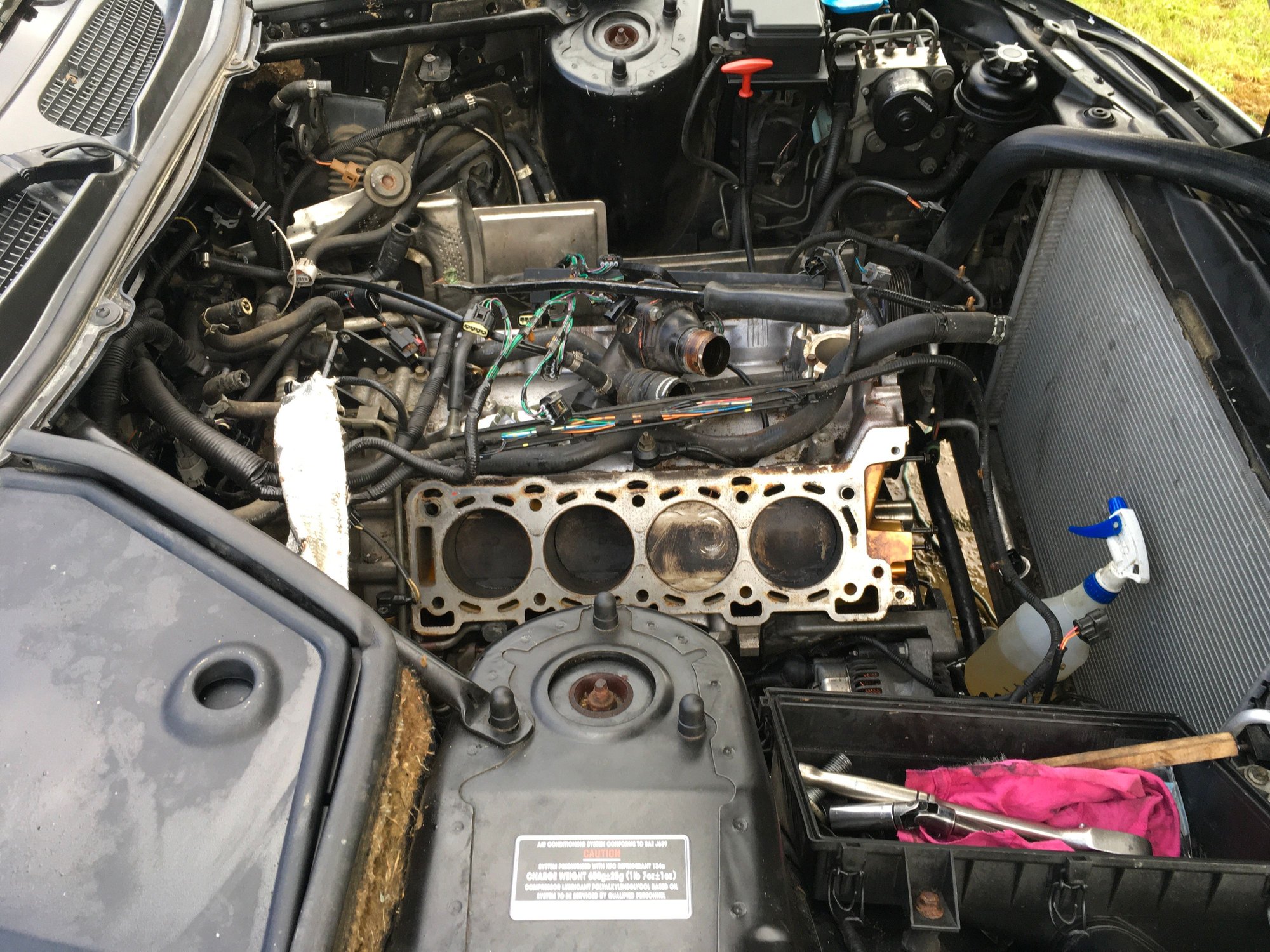

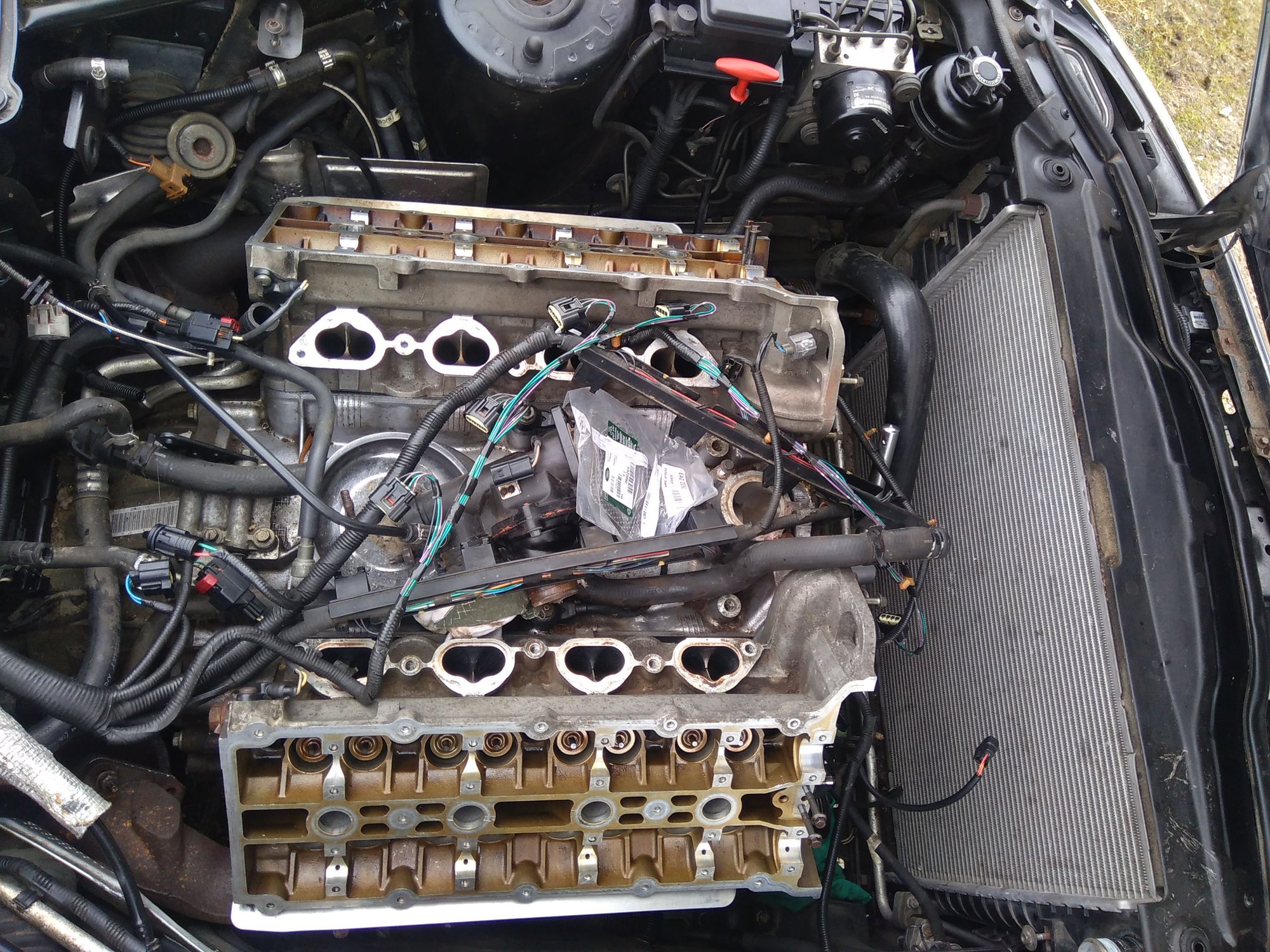

PROGRESS!!
l had forgotten how much i dont like really leaning on stuff hard, i like to ease into it. lm happy its all off. l seems all LOL, all i need on top of gaskets, cam tensioners etc is one cylinder head. lm very pleased though, i managed to only break 3 of the 8 exhaust studs, fortuanly due to clever design there is plenty of meat left, so when i have some more O2 for the blue spanner im sure with the help of Mole grips they will come out

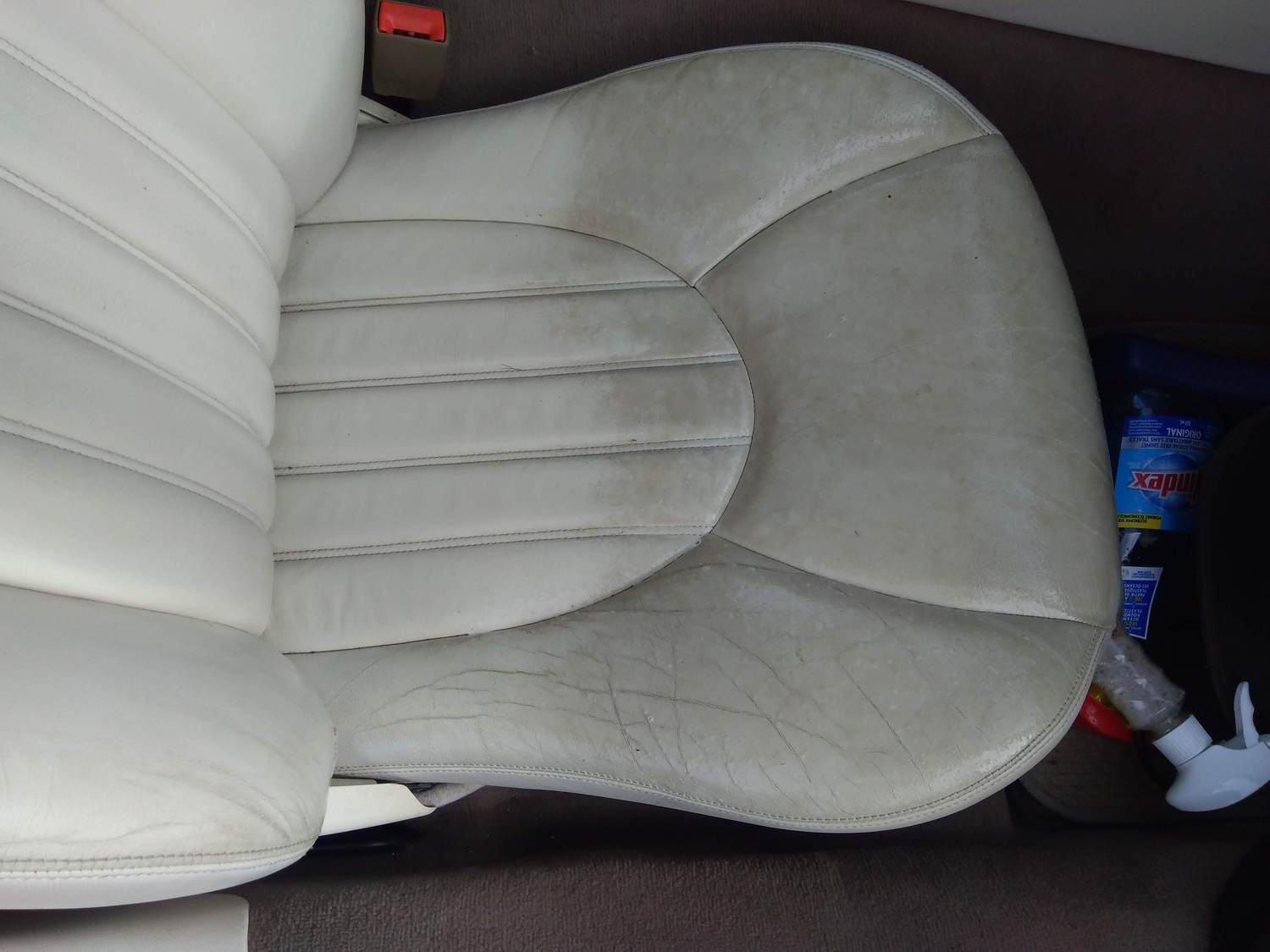

l also did some cleaning, i dont think ive ever cleaned the inside or outside of anything that doesnt work, rarely clean the outside of my daily, must be love. Good old saddle soap, the odd thing is, it was a woman owner

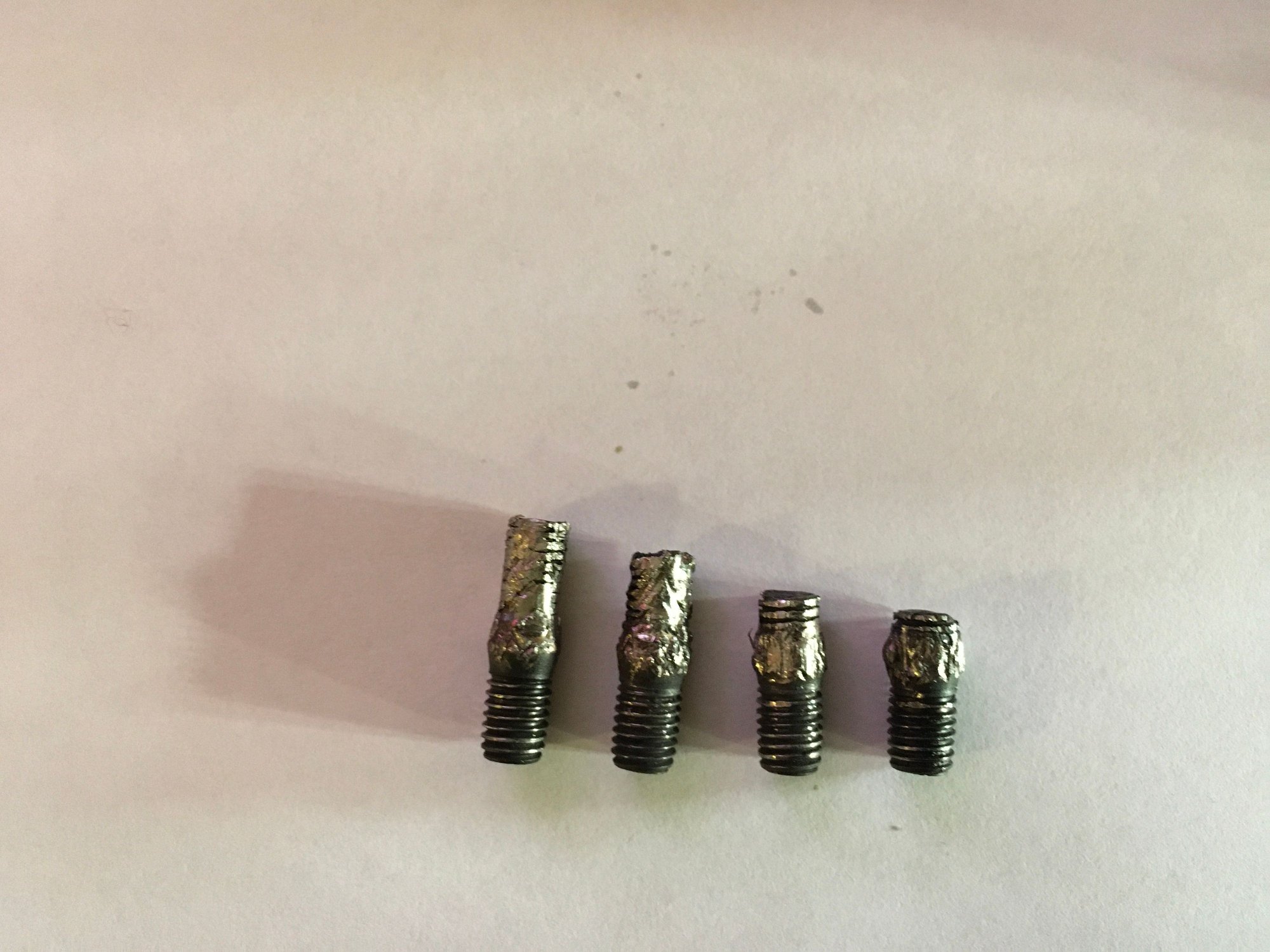

Default Sheared exhaust studs
..stuck in the cat pipe flange are out.
Heat, PT blaster and new 1 x 5''ish vice grips, 1 x 8''ish vice grips.
