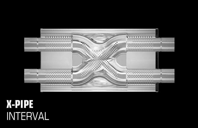

i'm going to do handmade a 2-1/2" stainless steel sport exhaust, under rear axle, with tru-x perforated core center muffler and 2 rear straight through perforated core by Magnaflow.
3-1/2" quad rear tips by Remus ( you can see OEM vs Remus )
2 sport cats 100 cells with the addition of 2 emulators to avoid errors to the control unit of the car.
sound + performance!

What brand of center muffler are you using? Keep us updated, want to see those tips!

mufflers made by Magnaflow

I like that x-pipe muffler. Do you have a part number for it? I can't locate it on the Magnaflow site
