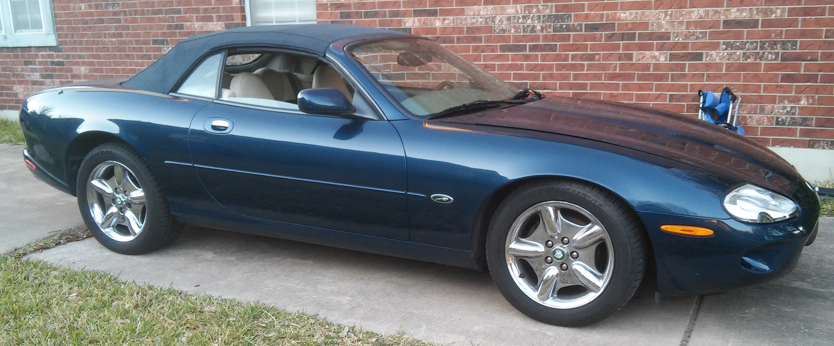

Thought I would start a thread on my adventure after reading another one done here. I think my starting place is a little better but feel free to flame me with any are you out of your mind comments.
While recently finding myself wanting another convertible in my life I started searching the web. I have to first say that this new fangled internet thing is a real problem for the mildly addictive personality. After searching the several sites I found my new love on the car dating site known as craigslist. There I ran across an ad for a car I always thought was one of the most well designed looks of all time.
Sapphire Blue 1997 convertible was staring back at me from my laptop and of course the price said come see me, my first inclination was something must be wrong with it. I spent the next few days reading here and other places about possible defects that would be out of the norm repairs for a 120K mile car.
The biggest scare was the early motors having issues with cylinders which sounds like it be a real deal killer. Well after a few days I got up the courage to call and visit. I have to admit I was actually surprised to see how good it still looked. After a few minutes of conversation we got to the part that would tell the first truth of our relationship. Standing behind the car I was pleased to hear a quick relatively easy start with no smoke or funny smells. Well that is all it took for me as at the price I was convinced with the work the owner said was done in the last couple years including a new transmission, new belts and hoses, less than 10K on new tires and the top operated perfectly I thought it was worth the risk.
Now basically being hooked for the things immediately bad.
1. The final straw for owner and why they were selling was the steering leaking as a diagnosis of $2500 to be able to drive it again. Not the best since no test drive could be done, but at the worst a full swap of system would fix it.
2. The obvious issue with the chrome revolvers due to living up north, the age and salt have worked its way in there causing one wheel to have an issue holding air, pitting and pealing. I will have to see what can be done to save or replace as I have to. My guess is no more than $400 for some used Jag wheels as my initial thought is keep it all Jag.
3. Clear coat is pealing hood, trunk and a little on top of rear fender. Will have to see how well things go before tackling the cost of new paint, but sure I can get it to something close to a 20 footer with some touch up in the driveway if things start to go bad.
4. Suspension is exactly what you would expect to find in a car almost 20 years old, time for all new parts. If is a joint or bushing it is time for replacing.
5. Minor interior issue with door panels from work being done internally however no seat tears in leather.
6. Climate control LCD going out so you can't read it being about half black.
While I was never a mechanic by trade I always liked the challenge of working on cars. I have bought more cars with over 100K than those with less. My most recent project was with my daughter and her first car a 98 TJ Wrangler we brought home on a trailer. Took us two weekends before we could take if for a spin. Then all the normal stuff for a car with 150K miles.
I am sure to find other issues as I get to drive further than on and off a trailer. Stay tuned and I will try to share how things go with the adventure and what I find for best information on repairing things. My wife says I am the King of finding deals.
