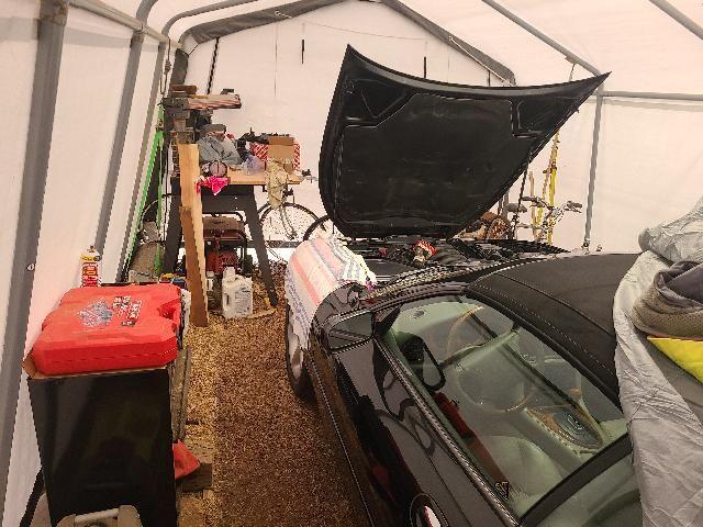

This thread is to document my secondary cam chain tensioner replacement project. The car is new to us - it is a 2000 XK8 with 70300 miles and had been kept indoors for much of its resting life. There are some records that indicate that it was well cared for. And looking at it it appears to have been taken care of. See my signature for the current project status. The goal is to make it road worthy for my wife to drive. It was her present...
In posting about the other projects folks have been telling me that I need to get to the secondary came chain tensioners first. This is of course great advice and though I did not express my understanding of the need very much , it was always on the top of my list. We had a break in the weather and as that I do not have a garage (going to build one RSN... real soon now) I took advantage to do the right side tensioner in the 4 or 5 rain free hours today. In the end I did get rained on and got most of the replacement done. Here a few photos of what I found. Of course there were a number of glitches and other problems to overcome along the way.

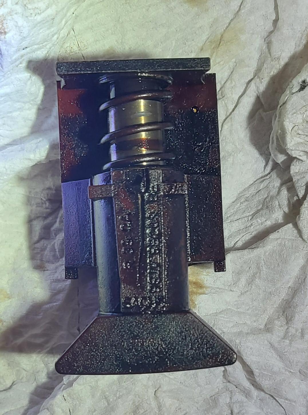

The three photos show the old tensioner in the car, the new in its place and the old outside of the car. Notice the huge crack along the body of the old tensioner. It was still working because of the metal sleeve internally. Who knows how much life it had left. This really illustrates the advice from the forum to not drive the car till you know you have good tensioners.
So I am half way there RE tensioners. I'll be waiting on a sunny day to get the left side. Hopefully the parts to finish off the shocks and transmission will arrive soon too!
Of course kudos to all those who have gone and done the hard work to figure out how to do this.
As a side note the local shop (Kings Cross) quoted $3000 to this work - parts and labor.

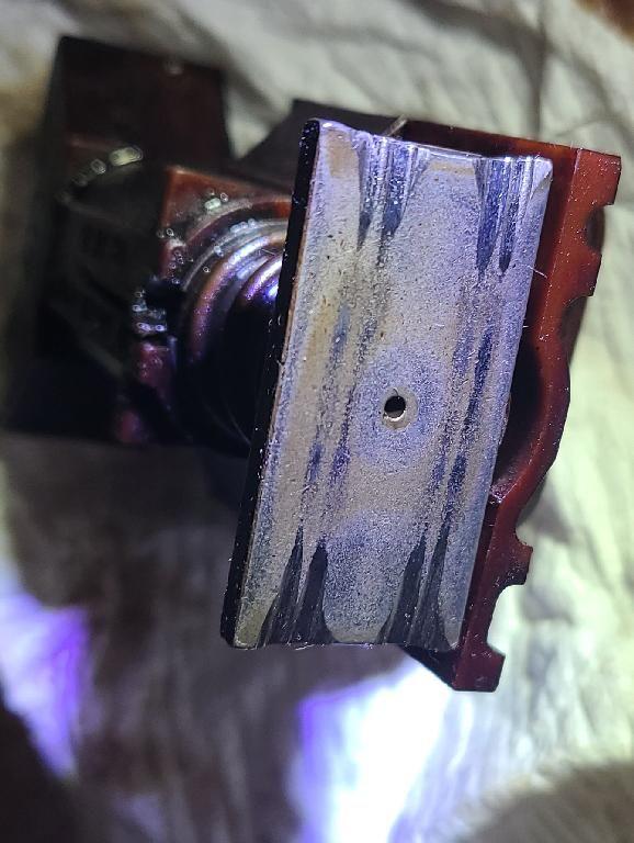

Got time today to replace the left side secondary cam chain tensioner. This side was in worse shape than the right. It has the same long crack but also has lost its shoe. With all the advise about doing the primaries I've placed their replacement on my todo list. Sometime in the spring. It is about 50 outside and with a 5000 BTU heating going I was able to get the temp up to 60 (15.5 C). Not bad actually but the various plastic pieces were more brittle than ever. I'll get back outside and run it with the ECU fuse pulled and then put it back and start it up to see if all is well.
As a side note it appears that the left side had more gunk in it than I recall for the right side. I'll have to look at the photos to see if my memory is faulty.
I thought the left side was easier to do. It was nice that I did not have to open up the coolant system, just move the expansion tank aside.
