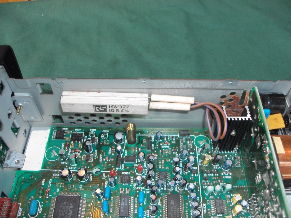

check you have 12v on the two purple/brown wires and the white yellow wire with the ignition in position 1. If not, the problem is not inside the head unit.
If that's OK, look inside the head unit. There's a resistor behind the heatsink at the rear which gets overheated and blows. Picture shows replacement - bit fiddly but not impossible ........... !!

Hey Bubba, thanks a bunch. You are the guy. That resistor was my only suspect being it is a little browned. It has 12v at the top end of it.

If just a little "browned" - might not be the answer !! Mine was - in burger terms - "well-done".
