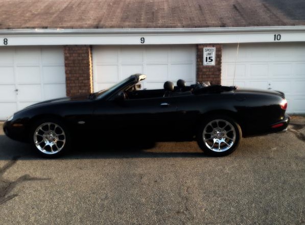

I have a black 2001 XKR Convertible. I have a few issues I would like to bring up to see if anyone has advice before I go the dealership tomorrow.
The car was pulling to the right when I bought it. My mechanic wasn’t able to fix this issue. He isn’t very knowledgeable about Jaguars. About 6 months ago I started doing a heavy daily commute to an area filled with giant potholes. And I definitely hit some of them pretty hard. The car is riding really rough right now and I think the front end is shot. From what I read through the posts it could be a tie rod, bushings, and wheel bearings and/or power steering.Last year the dealership told me I needed to have the CATS suspension fixed and it would be very expensive. Oddly, they didn’t seem to think it was necessaryfor me to do at that time. (Sorry I am not mechanical at all.)

I don't know how to add a photo of my car to this post. But it is located in the Photo Albums.

I've taken the first photo from your album. The second was way too distracting.
