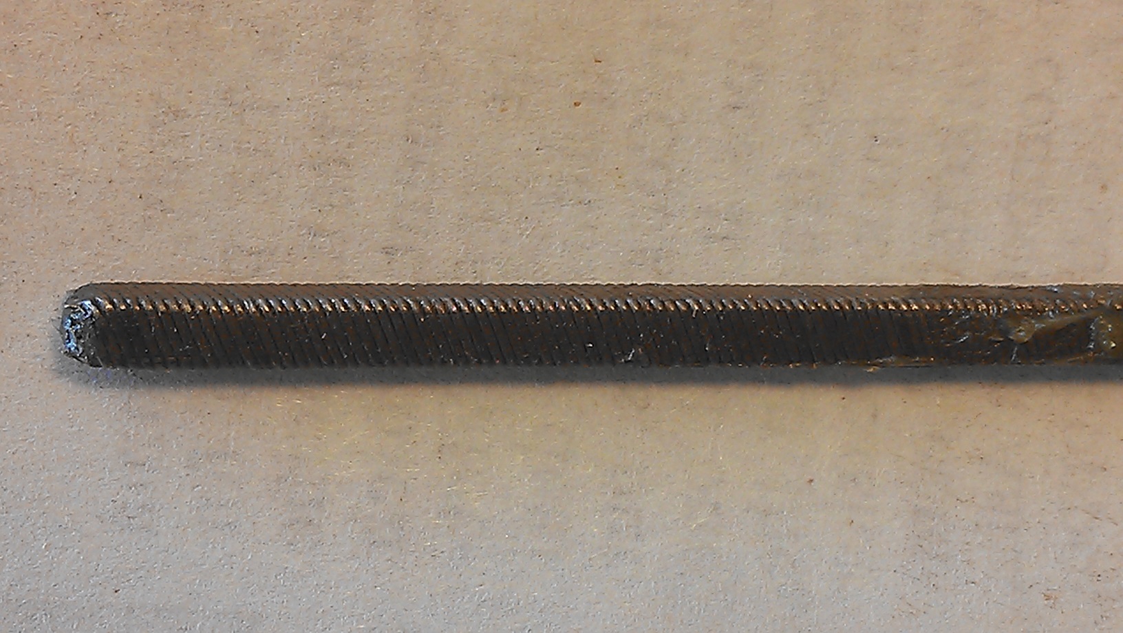

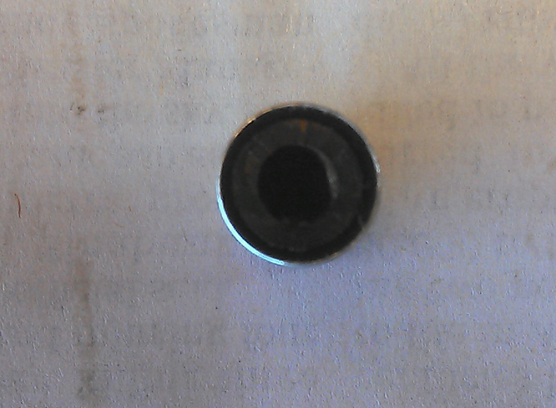

After sifting through the useful banter I decided to fix my headrests today, and used the ferule cutoff method. There is about .6" of sheathing inside the ferule, so I cut it off flush (after pulling out the cable), the repair specifies 12mm, which is .47", but loosing a little extra is no issue. I then made several lengthwise cuts in the sheath that was in the ferule and pushed the pieces out through the big end, since the prongs inside make it difficult to go the other way. To reinstall the ferule I just heated the end of the sheathing a bit to soften it, and slid the ferule back on quickly to where the original end terminated. On my first try I didn't get it on far enough so heated the ferule and sheathing together and pushed it in a little more. I thought that I might have to run a drill through the hole to open it up a bit, but there was no issue there. The only problem I had was that I put the cable in upside down (I admittedly have a short memory) and struggled with re-installation, so remember that the long flat end goes down into the motor, the short end into the headrest. Now if I can just remember where I put my assembly fluid (IPA)......
