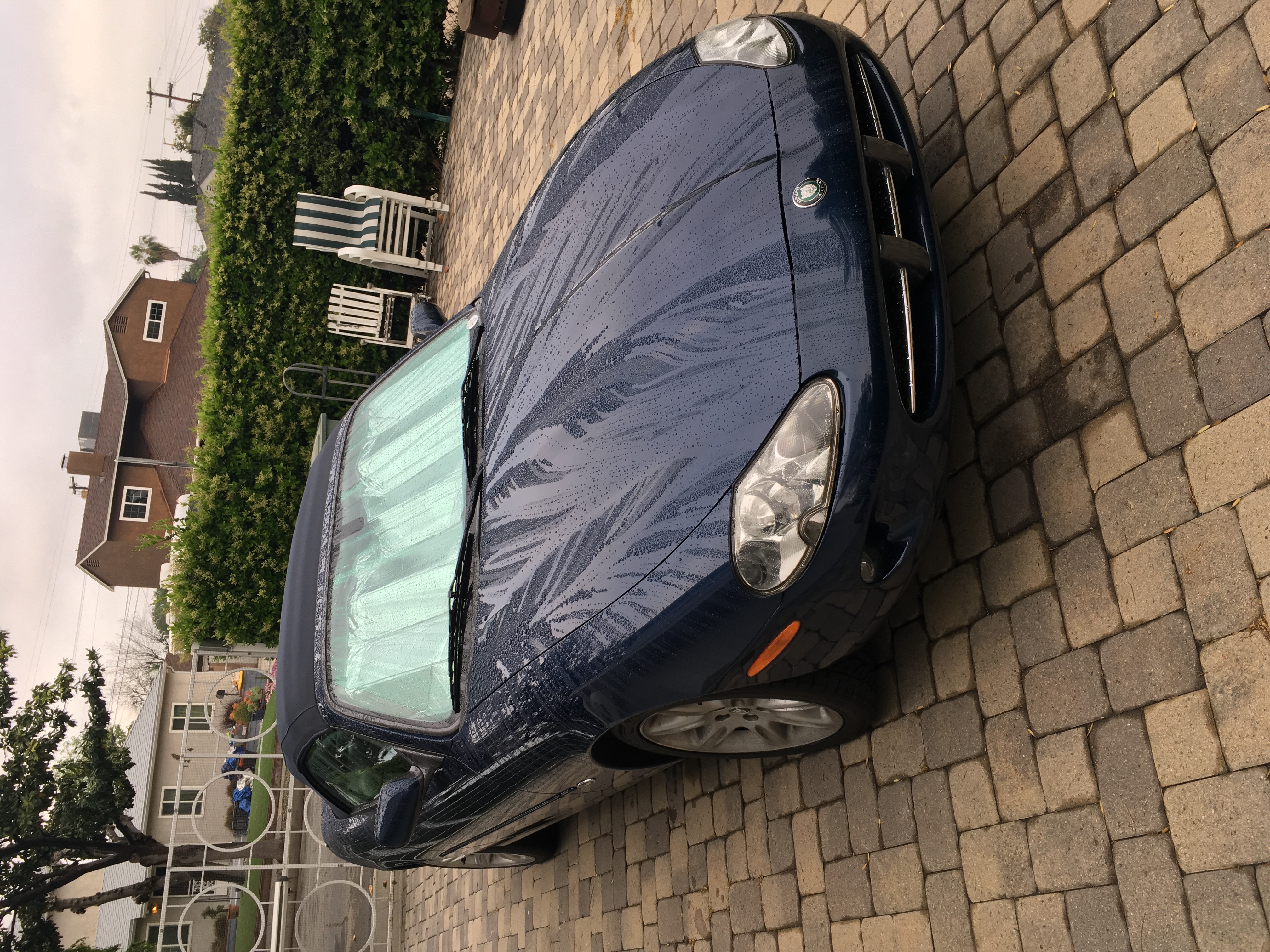

Hi I purchased a 2000 XK8 for my wife a month ago and joined the forum and have been reading it everyday since. The car has low mileage 45K and upper shock bushing were shot crumbly so I purchased the welsh poly mounts and had them installed along with new front rotors and pads and Bilstein shocks,4 wheel alignment and new front tires. I now have a shimmy i feel in the steering wheel and when I go over bumps it does not feel right and tight (damping). I have had the front end looked at by the mechanic who installed the shocks and mounts and voters and pads he said the rest of the bushing are fine. I also had the guy that installed the tires say the same thing btw the tires were balanced on the machine that adds pressure to the wheel if forget the name of it. So I am hoping some one can shed more light on this issue. The shimmy does not get worse with speed but it is always there and slightly. My thinking is the damping is causing this issue? Maybe the shocks are bad?? Any who I have also read the other posts about shimmy and shock mounts so I could use your help if you know what the issue is. I also on another note smell gas and coolant from time to time so I assume I have a vacuum leak and a small coolant leak as I see some moisture on the right side of the engine but no dripping underneath and no oil leaks.
Any help would be most appreciated...

Perhaps the problems are caused because you park it up the wall, as shown in your photo.
Regarding your steering. The steering is very light on these cars, noticeably so. The other rather obvious one to check is your tyre, or tire if your in America, pressure. Over inflated tires/tyres will cause a lot of problems.
Water under the car could be just the aircon dripping.
