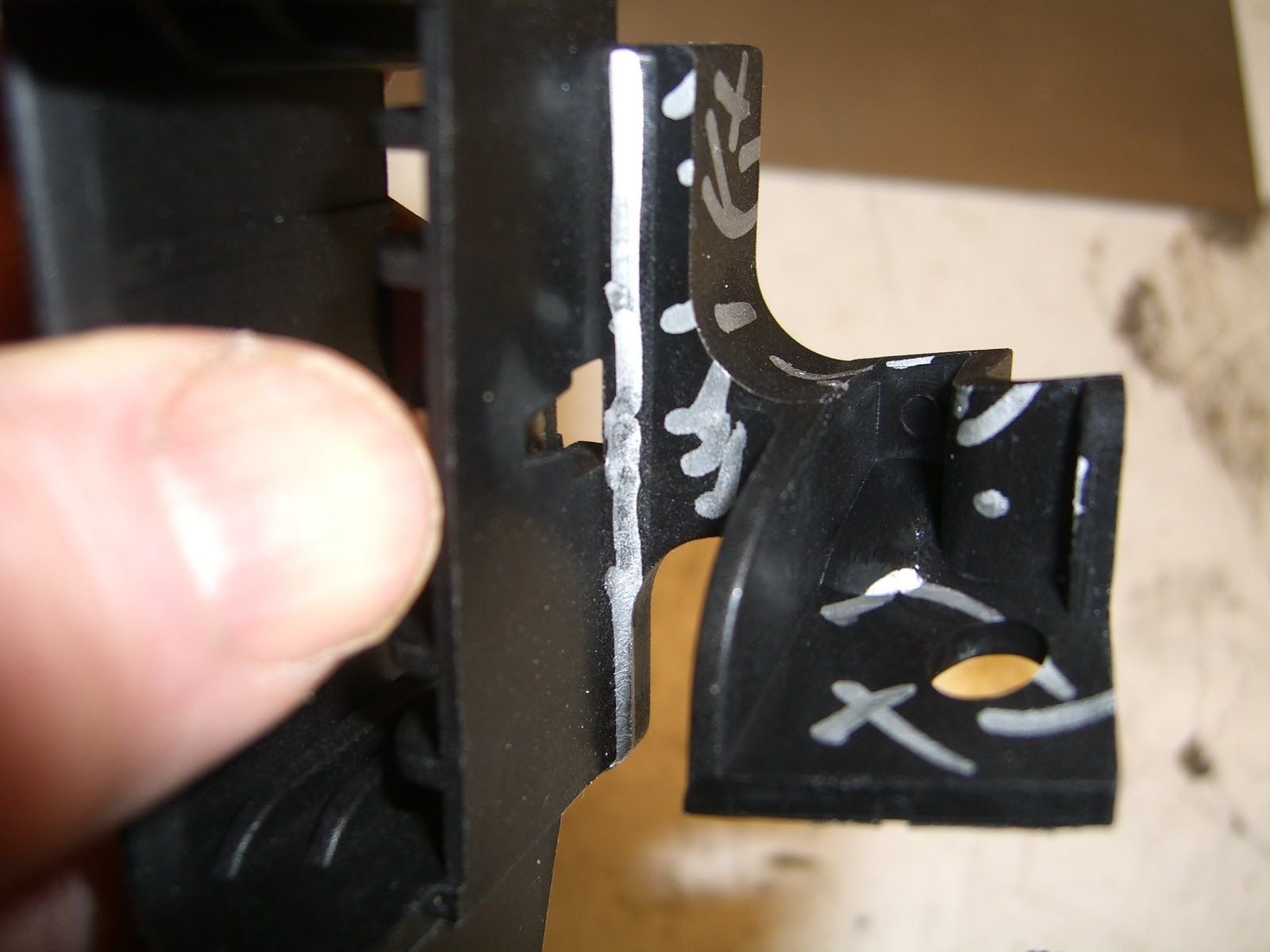

Sorry to revive an old thread. But I find your solution interesting. Can you elaborate on how you attached these to the car? I've been looking at pix of the base and I figured it would be easier to ask than to try to reinvent the wheel.

Installed these now on 4 different vehicles. They work well. It's been a while, but basically you cut off part of the base to make the side that faces the console flat, drill two holes through the base and attach it to the side of the console with two screws with nuts on the back side. Then then chrome top slips on and is attached with supplied mounting screws. Removing the console makes it a little easier to install, but you can do it with the console in the car ( difficult).
Lost most of my pictures, but here is one showing what to cut off. It will be pretty obvious once you have one in hand.
Thank you very much! A picture, thousand words, etc., etc. This tells me exactly what I wanted to know.
