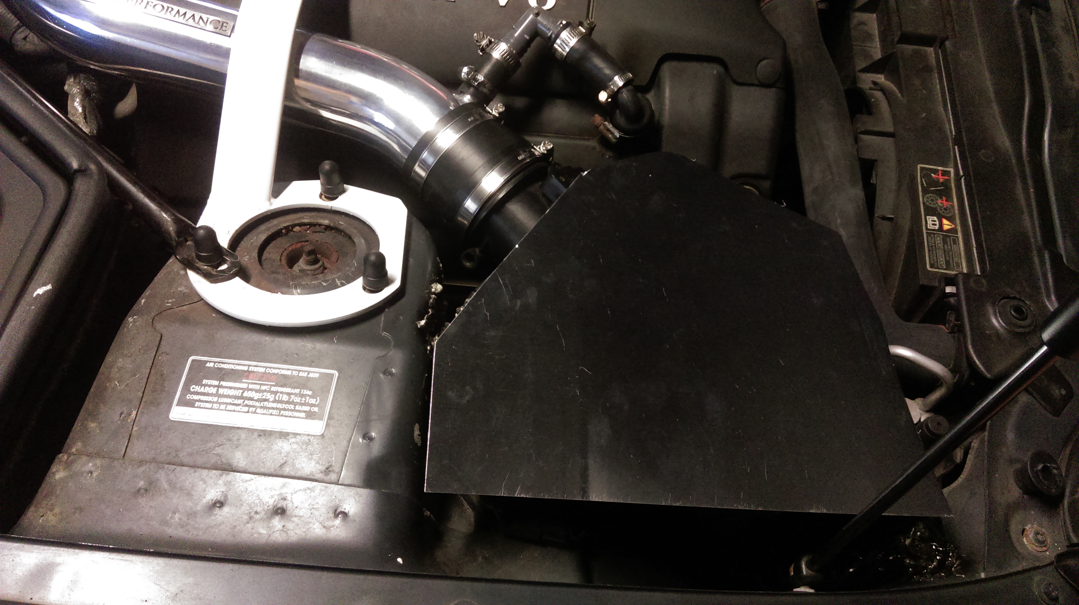

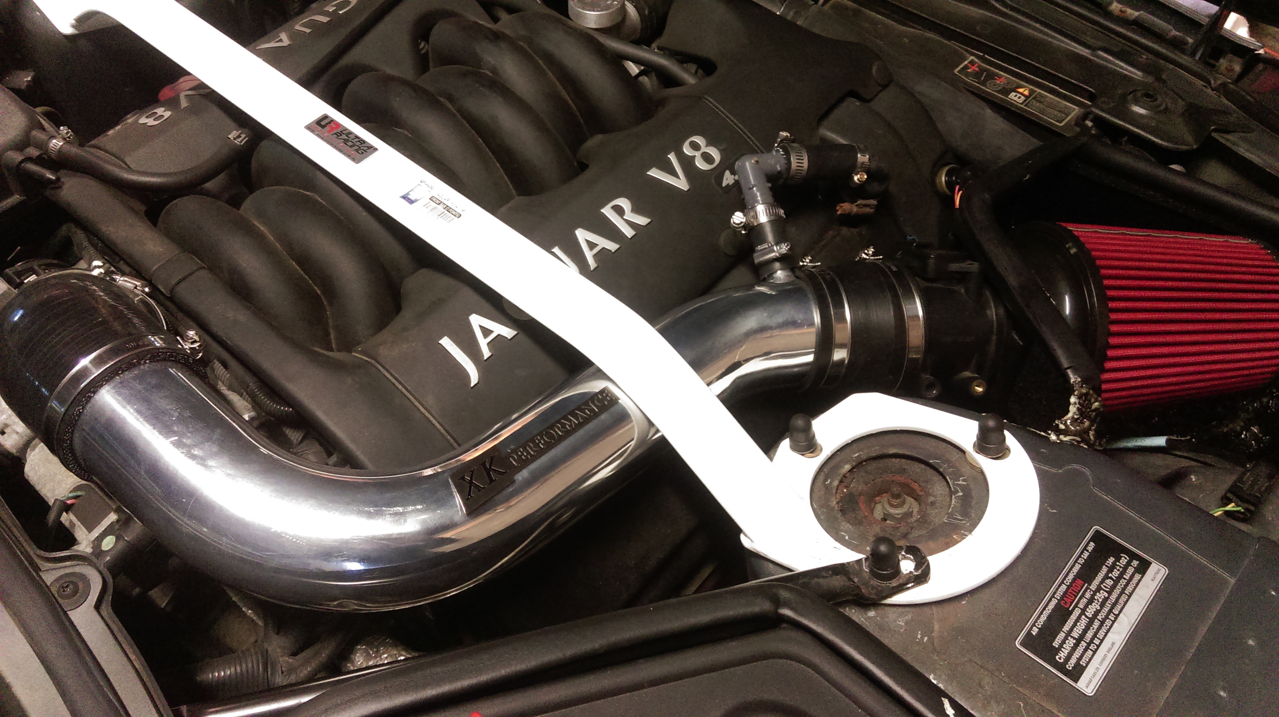

In the past I posted about a Mina exhaust system and air filter box I installed on my 2000 XK8. Mina just came out with a aluminum intake duct to replace the OEM plastic piece that came with our cars. This one is 3" in diameter with no sharp bends to impede air flow. And it looks incredible! I also fashioned a sheet metal baffle over the air box in an attempt to isolate it even further from the hot air in the engine compartment (crude, but effective). On the highway, intake air temp is a few degrees above ambient.
Here are some pictures. The white bar connecting the shock towers seems to minimize cowl shake and possibly improves handling. Very satisfied overall with both the aesthetic of the new intake tube and its effect on performance. The car seems to have a better throttle response at all rpms, and the intake and exhaust sounds combine to make lovely music together.
What was it with the stock intake?

I never did a real analysis of intake air temperature with the stock air box and filter (by the way, I have a new K & N filter if someone wants it). With just the "open" Mina air box, the intake temperature ran 5-10 degrees above ambient (but that was a month or so ago when the outside temperature was much warmer than it is now).
As far as my perception of better throttle response, and perhaps a bit more power at all rpms, that's a seat-of-the-pants assessment. Who knows what effect on objectivity the enhanced exhaust and intake sounds have? Bottom line, I'm pretty happy with the overall improvement, so that's probably all that really matters.
You'd find that it's pretty much identical to what you have now. For reference, to get a 1% power increase, intake temps must drop 11*F. The open system you had previously was admitting underhood air- with the corresponding power loss from higher temps.
The stock system is also very efficient with respect to airflow. Jag didn't leave much on the table.
Your gains are from an esthetic and 'sound' perspective, but that's about it.

The OEM pipe varies in its inside diameter between 3" and 2-1/4 over it's length and has sharper bends which increases friction. Also, the accordion pleats are going to cause turbulence in the incoming air stream. The Mina pipe has a 3" ID throughout its length, and is smooth with gentler bends. The benefits are likely minimal, but I'm sure they're there.

Did you install the air box upside down? why is it enclosed? the Mina air box is an open air box...Something I missed?
