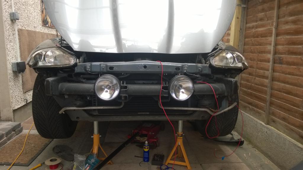

franksm, I love those big driving lights behind the grille! What are those?
Thanks rauscs ! I took my cue from exotica like the Ferrari 250GT and Ford Mustang (yes, that would be exotica to me on this side of the world)
The lamps are 6" driving lamps, Ring RL020G
Ring RL020G
I removed the bumper (because my grill was connected to it from the back) and chopped into the plastic crossbar there, and wired it into a relay from the high-beam wire. I like it, the look suits the car.

Nice job - I've always liked the look. Thanks for the info. Steve
