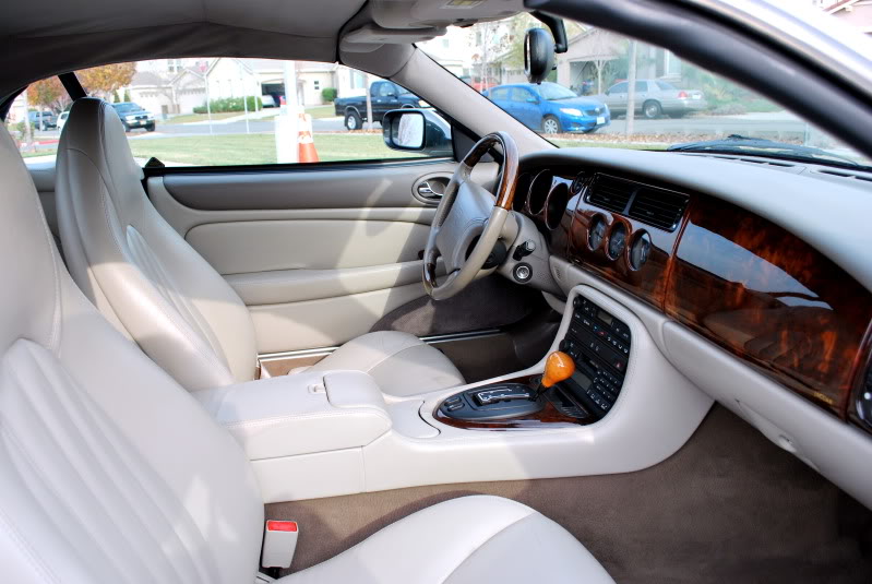

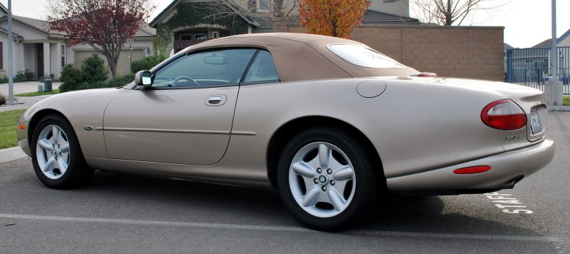

Here are a couple pics. Thought I was a hotshot, and cleaned the TB and MAF with the great directions on here. Now my CEL is on. I'm scared to disconnect the negative terminal to (hopefully) clear the code since I don't yet have the radio code. With all the books that came with car, the code wasn't there...

Georgous car!
US cars do not need the radio code, you can disconnect the battery.
Double check all your connectors and intake hoses are secure. Also drive the car a bit a see if the CEL clears on its own.

I looked up trautobro's car and his wheels are Centaurs. They are 18x8 and 18x9 staggered fitment.
They are similar to the fluted seven spoke "Sport" wheels that I have:
I highly recommend 18s. They don't ride rough and fill the wheel wells so much nicer.
If you are stubborn and must stay 17" the only decent OEM options are
Gemini:
Or Lamina:

Keith and WhiteXKR, thanks so much. I'll try disconnecting the battery. The car's running great other than the CEL.
Those Gemini's look great. One thing at a time though...

So I cleaned the MAF again, and now I'm running in Restricted Performance mode. Really made a mess of it...

Seriously, I should have this car taken away from me. The Restricted Performance light came on because I neglected to plug the MAF back in after cleaning it. D'oh!! The CEL is still on though. And I don't need a radio code either.
If that is the only issue, the CEL may clear itself after a few drive cycles.
